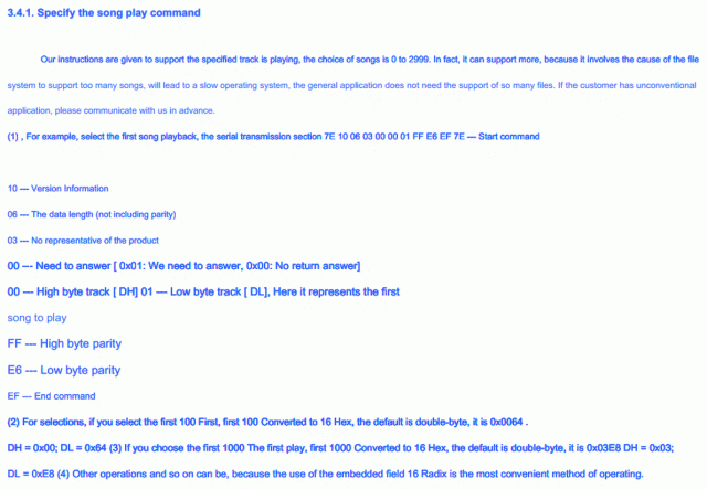

This is the 'Engrish' page from the manual for the module, but it is hard to decipher due to the broken English.
I am trying to work out exactly what they mean here, but I THINK they mean that you need to specify two bytes for the file number if bigger then 255 - they show the example of 0x0064 for decimal 100.
I have also attached the PDF, but the rest of it is also quite hard to understand.
YX5200.zh-CN.en.pdf
In the examples I gave in the first post, THEY WORK PERFECTLY for any file number up to 255, so I am only trying to work out how to request file numbers bigger then 255, but this is where the datasheet is confusing me more then helping me due to the typically bad translation into English.

It looks to me that it always wants a two byte song number. I think TassyJim is correct - CHR$(&h01)+CHR$(&h00) would represent song 256 and CHR$(&h01)+CHR$(&h01) would be song 257...
Posts: 10116
Posted: 03:07am 29 Dec 2019
Yes, I think you are correct.  I note that in my example in the first post, I am actually giving it the high-byte 0x00 as part of the command, so I think Jim is spot on, so I will change the code slightly, and let everyone know what happens.
Posts: 10116
Posted: 03:10am 29 Dec 2019
JIM WAS CORRECT!!!!
