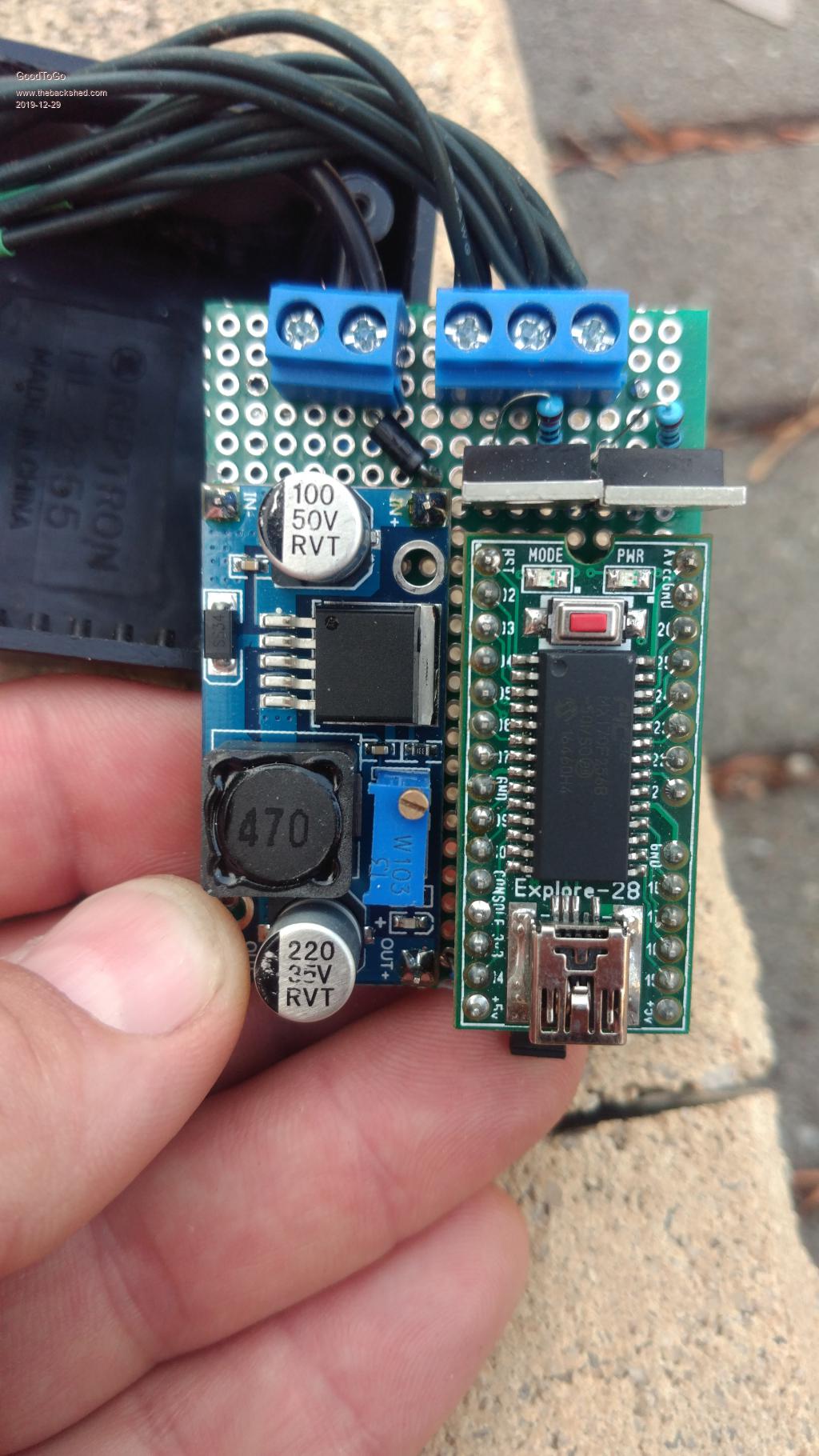

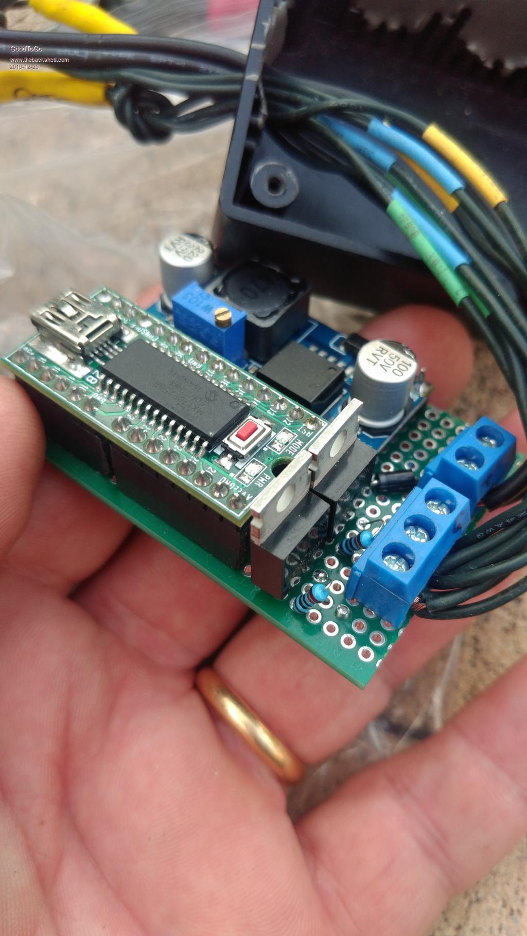

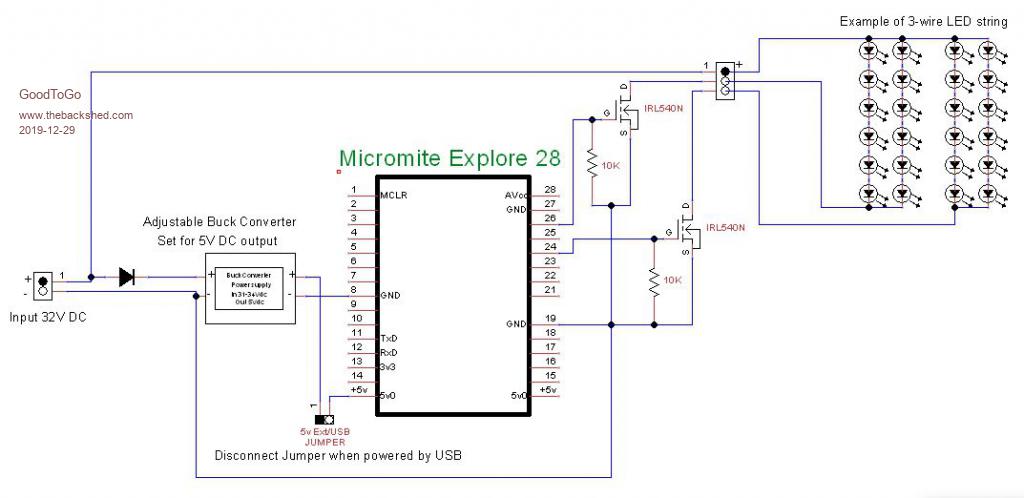

Howdy all, and I hope you are all having a great festive season!
Anyway, one of my christmas light crappy multi-function controllers shat itself.
So enter an Explore 28 module! I designed a quick circuit and roughed up some code to imitate some of the routines the crappy 3-wire multi function controller used to do:-

Works great and is happily driving the 3-wire LED strings on my fence. However I would like to drive another set of 3-wire strings using the other PWM channel in the MM as well. But having the channels run different routines at the same time. e.g. the first 3-wire string on PWM channel 2a/b running, say, the slowfade routine, while the PWM channel 1a/b is running the chase routine.
Is this at all possible? Do I have to timeslice somehow?

Thanks for sharing the code though. I'd love to see a schematic of the hardware too.

Howdy all, a couple of pictures and a schematic for you all:-
As you can see, there's not much to it. An ebay-special buck converter drops the incoming 32Vdc down to 5Vdc for the E28 module. The 32Vdc then just goes to the connector for the LED string. The two negative sides on the strings are driven by 2 logic level N-channel IRL540N MOSFET's, whose Gates are connected to pins 24 & 26 of the E28. A 10K resistor connects each Gate to ground.
BigMik, I'll try to get some video footage for you......
