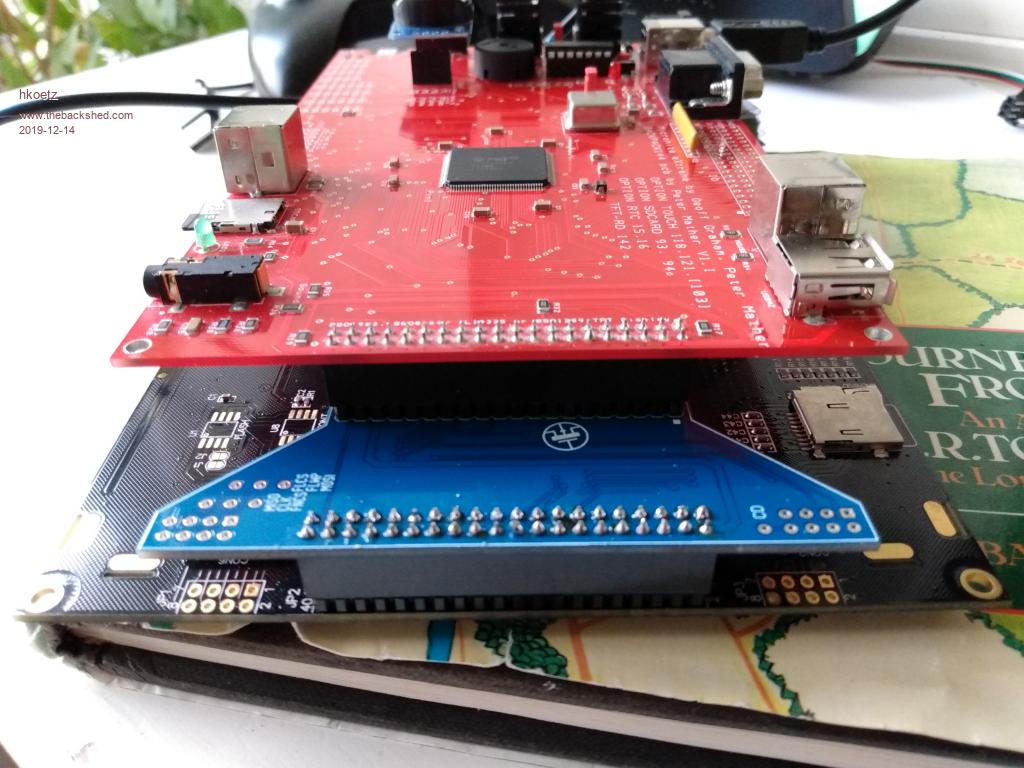

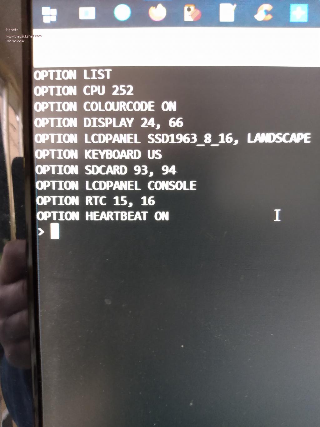

I have a Micromite Extreme 144, an EastRising LCD panel (8080 interface, 5 V power supply) and an adapter board from Rictech (see photos). The screen seems
to be totally dead. The options set are shown in one of the photos below. What am I doing wrong? There is 4.8 V between pins 1 and 2 on the panels interface.
Posted: 06:20pm 14 Dec 2019
Option lcdpanel SSD1963_8_16,l,,142
you need to specify the RD pin
Edited 2019-12-15 04:21 by matherp

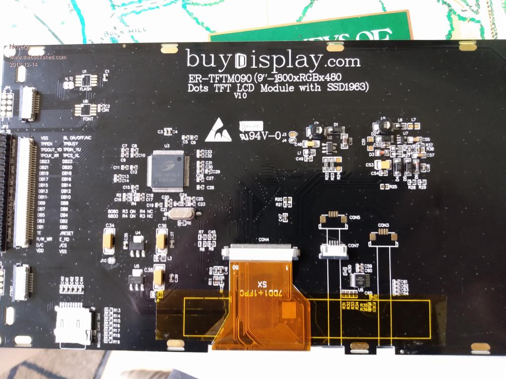

Rodgerg
Joined: 13/10/2019
Posts: 13
Posted: 08:04am 16 Dec 2019

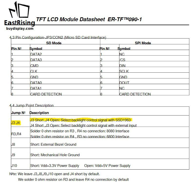

Have you checked the selection of J3/J4 on the EastRising LCD panel?
Looking at the photo, the brightness control is selected for external input (J4 closed/ J3 open). It comes with J4 closed by default.
Not sure about MMX, but with ARMmite H7, I think we use the SSD1963 control, rather than external PWM signal.
Matherp may be able to confirm whether this is a possible cause of your problem.

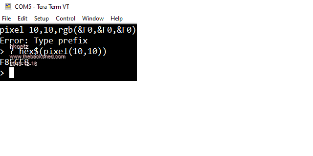

Posted: 10:47am 16 Dec 2019
  matherp said  How much power is it drawing? Sounds like the backlight isn't on. Try the following and post the result.
pixel 10,10,rgb(&F0,&F0,&F0)
? hex$(pixel(10,10))
Not much power is drawn. The two regulators on board hardly get warm. The results of you test is displayed below. On the LCD screen nothing happens.

Posted: 10:52am 16 Dec 2019
  Rodgerg said  Have you checked the selection of J3/J4 on the EastRising LCD panel?
The backlight setting (SSD1963) seems to be Ok according to the documentation.
Posted: 02:13pm 16 Dec 2019
pixel 10,10,rgb(&hF0,&hF0,&hF0) surely?

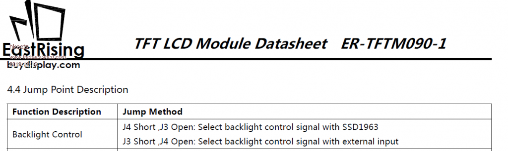

Rodgerg
Joined: 13/10/2019
Posts: 13
Posted: 08:32am 17 Dec 2019
Hmm.....
Very interesting.
The version of the manual I downloaded shows exactly the opposite settings for J3 & J4 as below
I downloaded this from
https://usermanual.wiki/Document/ERTFTM0901Datasheet.600261355/html#pfc
The footer at the bottom of the page says the document version is Rev 1.0.
Since two versions of the manual seem to exist, which directly contradict one another, it may be worth just trying J3 Short, J4 Open to see if this fixes the problem. It won't do any damage to the device and would at least eliminate one possible cause.

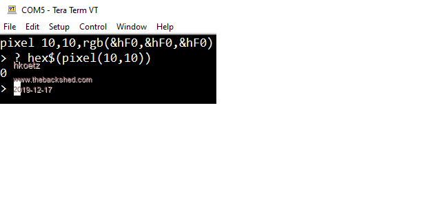

Posted: 08:36am 17 Dec 2019
My display which works has J3 made and J4 open has per the manual and yes the test should have been :

Posted: 11:21am 17 Dec 2019
  matherp said  My display which works has J3 made and J4 open has per the manual and yes the test should have been :
Result of the new test
Will try the switch of J3/J4 later. Can't get in the mancave now (granddaughter is sleeping there).
Posted: 12:48pm 17 Dec 2019
That eliminates the backlight - the display controller isn't responding - Have you another display you can uses on the MMX to eliminate it from the equation?

Posted: 06:35pm 17 Dec 2019
  Rodgerg said  Hmm.....
Very interesting.
That did the trick!
