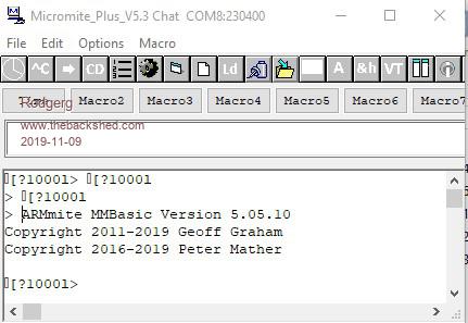

@KeepIs  Thanks for clarification Mike.
  Quote  depending on the external terminal program you are using, they may well be visible on that.
Your are absolutely correct.
I have been using MMEdit Chat as my terminal program until now as everything is nicely integrated in MMEDit for editing, uploading and controlling the Micromite.
Full screenshot below
With Teraterm, it looks like this
Much better
So, biting the bullet, I added the file upload and time setting macros to TeraTerm as per the MMEdit manual instructions for working with TeraTerm.
Interestingly, during some trials, TeraTerm was much quicker to upload a 31k file at 230k baud, so this is a bonus.
Upload time using TeraTerm   9.4 s
Upload time using MMEDit    25.0 s
Of course, one small contributor to the difference may be the crunch time, as I just get TeraTerm to send the pre-crunched .baz file, but I would not expect this to be significant.
I may still use MMEdit Chat for small tests, but the control codes appearing on the screen are a little annoying.
One thing I will really miss about MMEdit Chat though is the Linux-like ability to scroll back through recent commands with the up and down arrows, which I assume uses some form of keystroke buffer.
Thanks for your help
Rodger.

Posted: 08:45pm 09 Nov 2019
MMEdit hasn't kept up with recent changes to some of the MMBasic variants.
I will update it eventually but TeraTerm will always be a much better terminal program.
