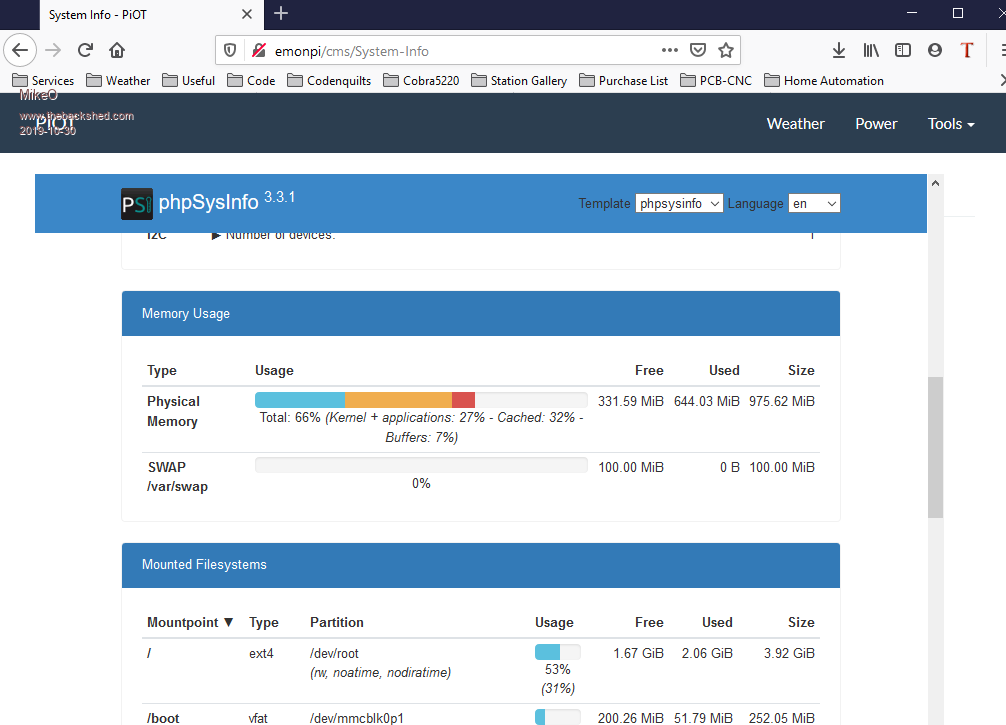

PiOT is the name I have given to a Raspberry Pi image I have made. Like many I imagine I have been experimenting with home data collection for several years, micromites, ESP8266 but more recently Raspberry Pi. I tried the RPI with mmbasic some time ago and that was successful but since I have spent a lot more time playing with Linux itself, that opens up a whole lot more possibilities.
So to PiOT, silly name but i had to call it something! As the basis of the image is a PHP app called EmonCMS which is part of the Open Energy Project in the UK but it is a terrific application for logging data, it also has great facilities for Visualizations and Graphing. EmonCMS coupled with Node-Red , mmbasic and a Simple but Powerful CMS (Typesetter CMS 5.1) for a Web U/I. All this wrapped together as a "ready to go" RPI image , for me , makes the basis of a nice Home Automation System with fairly limitless functionality but could also easily be a quick way to a logger/controller for many other projects.
The image is running Raspian Buster and is pre-configured as a headless system it has  MMbasic installed which starts in a screen session on boot up so at the very least the img is an easy way to try Picromite.
I will make the image available if any one want to try it anf will start some documentation on my website.  Mike

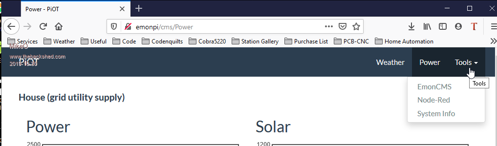

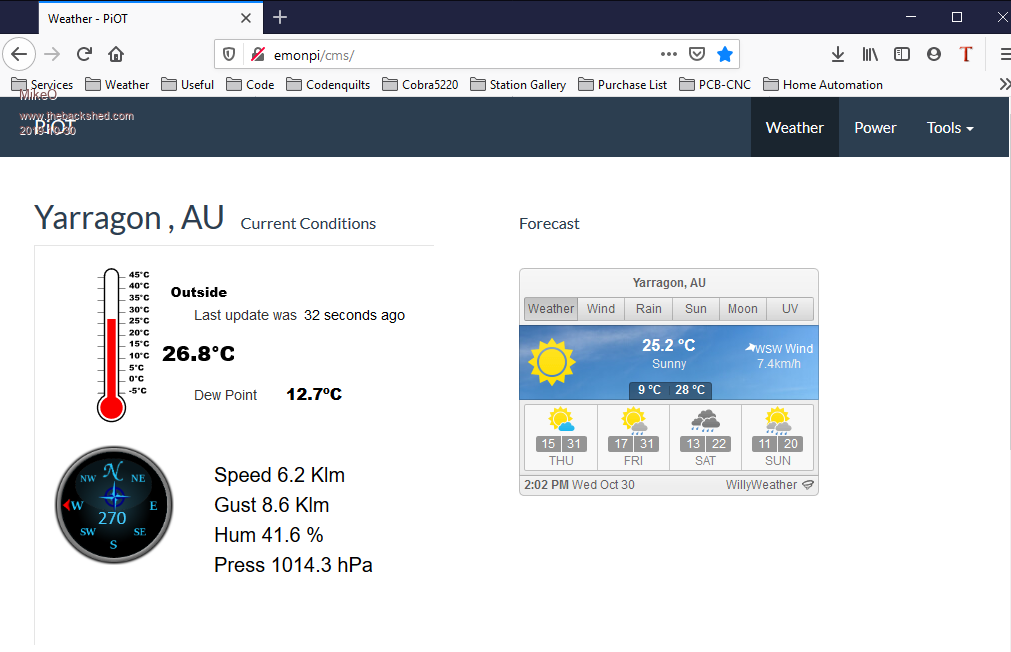

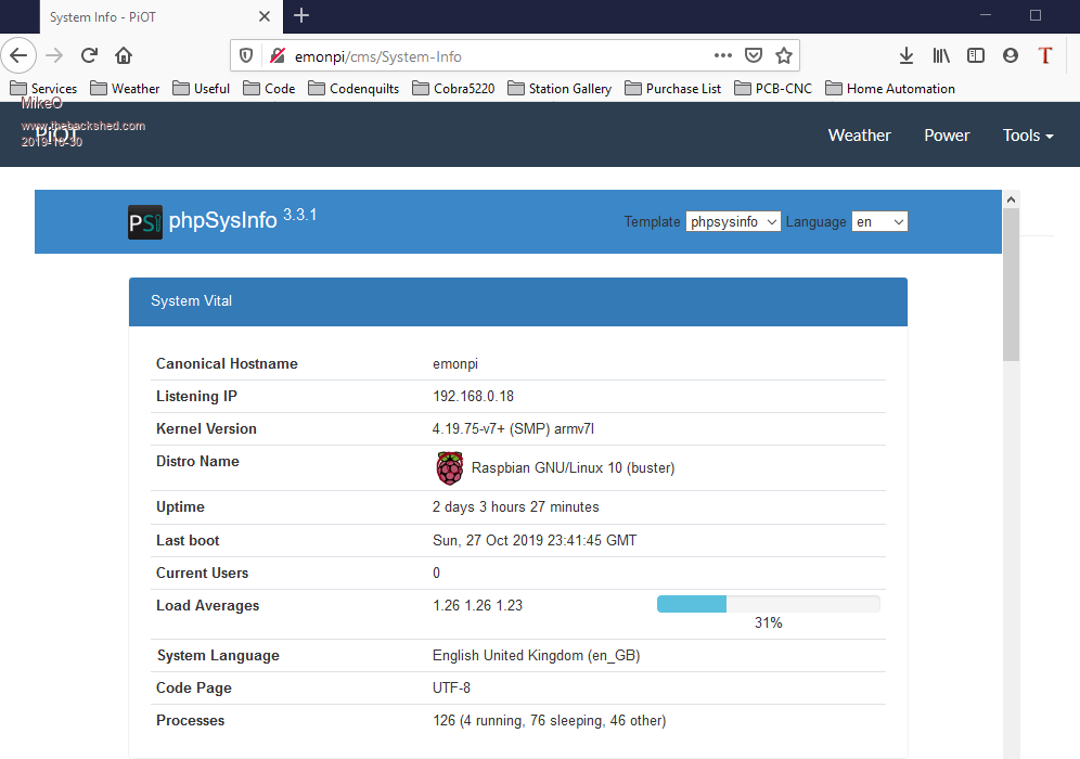

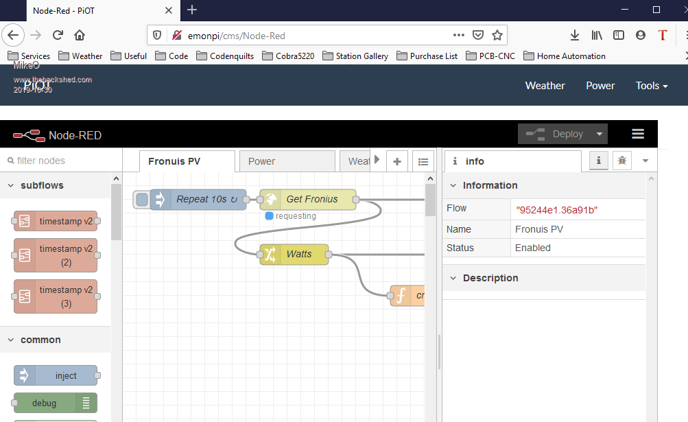

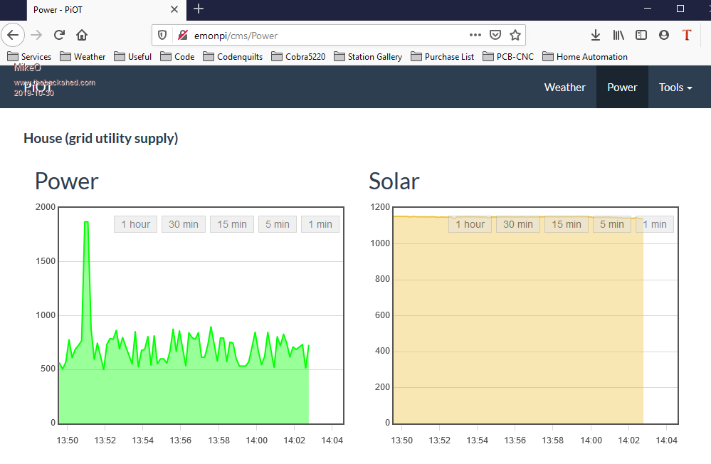

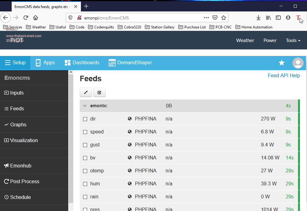

Here are a few screens from my working system.

Hi Lizby, mmbasic plays no part in the Web interface. It is just one of the tools available in the "compilation" .
In my case, for my current project for example , mmbasic performs some processing of my Grid electricity and roof PV supply data , it collects the data via UDP transmissions from the sensors, calculates then saves the results in a file. Node Red then reads the file and passes them on to the logger. Data from different sensors can be stitched together , logged , displayed etc by using the various applications as required.
The image is based on Buster, I have not really tried a Zero , I think it would be asking too much .
I will be posting the image tomorrow with some documentation.
For the Pi Zero, Single core and only 512 MB.
Yes if you want to use WiFi you have to edit wpa_supplicant.conf , ssh file exists.
