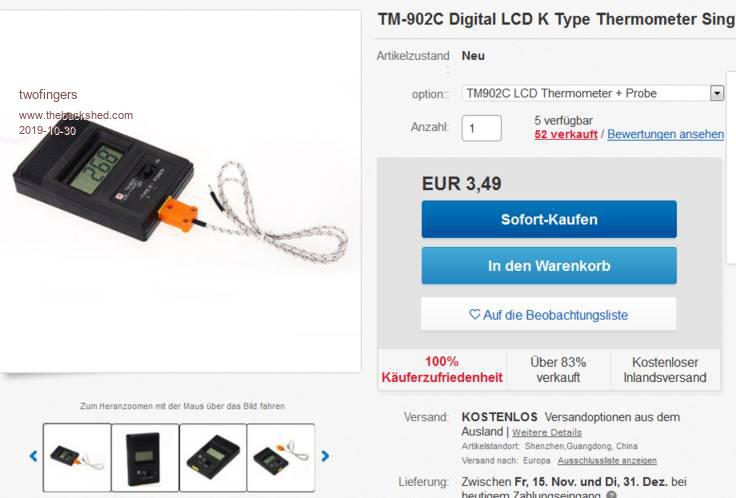

if you don't need an alarm function - just to display the temperature - I would try something like that
regards

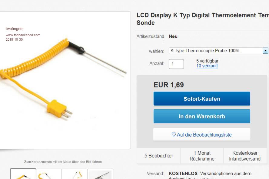

Hi Michael,
Thanks for the link and I've Googled for more. The inexpensive offerings I've found (I may not have seen them all) seem to not have a meat probe on the end (I want to be able to skewer it into the meat and leave it there while it cooks). The yellow one above does but it is not insulated enough to survive the ~400+C temperatures. It is meant to be plunged into the meat, take a reading, then be withdrawn as the meat is returned to the BBQ.
The type I linked to above does have a skewer-type probe and insulation to the connector. By being resistive (rather then a K-type thermocouple) it should be easier to adapt and calibrate (I hope)?

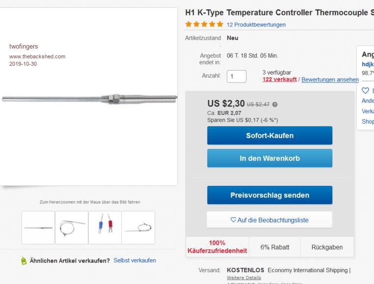

you are right! Here is another, more stable thermocouple.
But please do not expect the device to endure 1200 degrees!
400 degrees are probably(?) realistic.

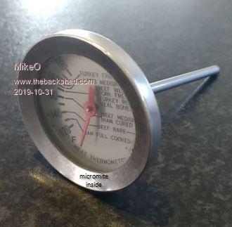

Here's mine,
Codenquilts

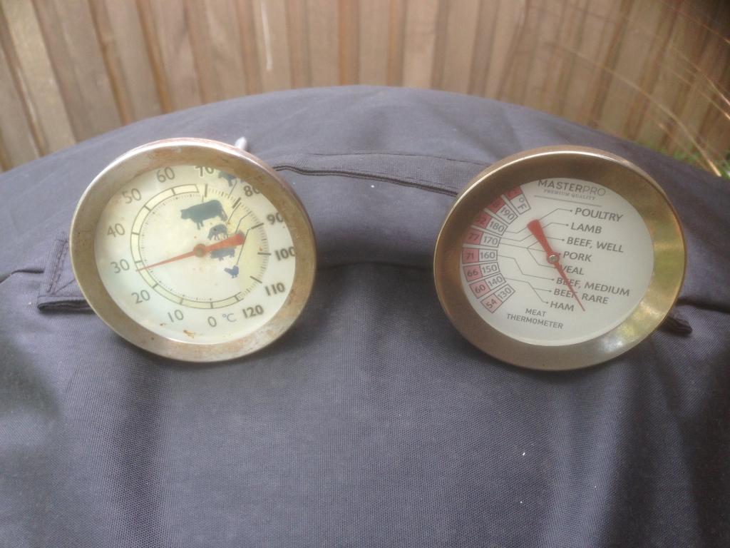

Here are two of mine (Oven & BBQ).
Cheers,
Andrew

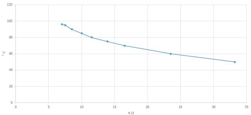

I've measured the resistance resulting from temperatures ranging from 0 to 96 degC (ie 240K Ohm to 7K Ohm).
The important range is really only 50 to 96 degC, ie 33K to 7K Ohm.
Now I know the resistance range, the big question is how to measure it with a MM170? ie How to measure a voltage across say 33k?
Cheers,
Andrew
Here is a plot of the Temperature vs Resistance readings from 50 to 96 deg.
Edited 2019-11-07 19:42 by Andrew_G
