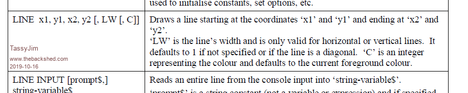

"However, the thickness parameter only seems to apply to vertical or horizontal lines. Diagonal lines seem to always have a thickness of 1."
See the Micromite manual in the drawing commands section
"Also, the thick line, when drawn, is not centered on the line between the end points. Instead, the line specified by the end points represents one _edge_ of a box that is 'width' thick. Hopefully that is not as intended."
As with all drawing commands the coordinates represent top left. Same for all MM

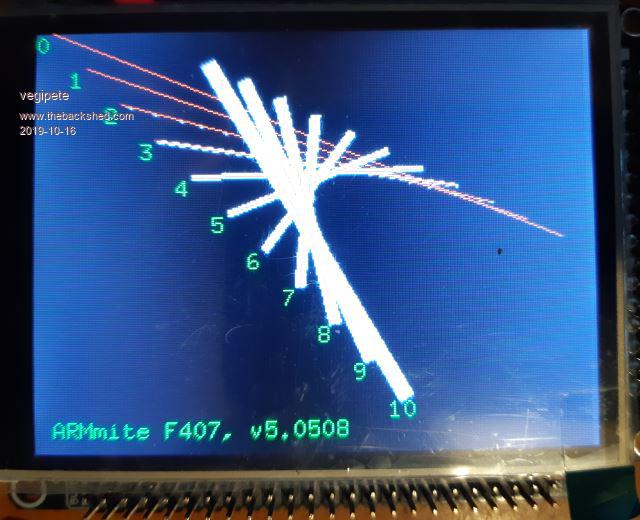

Anyways, I'll not gripe and whinge about it. I know that thick lines are not trivial. Instead, I offer the following code. Some googling found this thick line drawing site which evaluates and explores work by Alan Murphy Thick Line Algorithm.
I went through the presented code and rewrote it in MMBasic. Ideally this could be rewritten back into C and made part of MMBasic. The idea uses Bresenham's Line drawing algorithm to draw a line from start to end. Then, for each pixel (more or less) along said line, perpendicular Bresenham lines are drawn to each side to generate the desired thickness. (The code on the first link actually allows the width to be a function of distance along the line, so neat patterns are possible but I just went with simple.) All variables are integers, and there is only a single 'Sqr(dx*dx+dy*dy)' per thick line so calculations are simple. MMBasic kinda bogs down with this but does draw nice fat lines. Ends are flat and nicely aligned.
I haven't tested extensively to see if the resulting widths are exactly as expected. Widths are calculated in lines 107 and 200 but I'm not convinced they are 100% correct.
Also, I think the algorithm could be improved slightly for constant thickness lines. The short perpendicular lines are mirror symmetric so it ought to be possible to only calculate them for one side and plot the other side with sign-swapped relative coordinates.
Note there is at least one long line in the following code that may cause MMBasic to barf because it gets split onto the following line.
Option DEFAULT INTEGER
Dim INTEGER i
CLS
Font 1,1
Text 10,220,"ARMmite F407, v5.0508",,,1,RGB(GREEN)
For i = 0 To 10
 Colour RGB(GREEN)
 Text 20*i,21*i,Str$(i)  'Show line thickness at start of line
 DrawThickLine 10+20*i,21*i,300-20*i,120-10*i,i,RGB(WHITE)
 Line 10+20*i,21*i,300-20*i,120-10*i,1,RGB(RED)  ' red line down the middle
Next i
End

Posted: 06:20am 16 Oct 2019
Interesting algorithm.
If you aren't interested in varying the width along the line, you should be able to draw 2 or more lines parallel. This should reduce the calculations somewhat.
Re the manual.
My Micromite V5.05 manual has, in the command list:

  Quote  Re the manual.
You are quite right. I had version 5.1 open...
Maybe the version number could appear on the bottom corner of each page?
