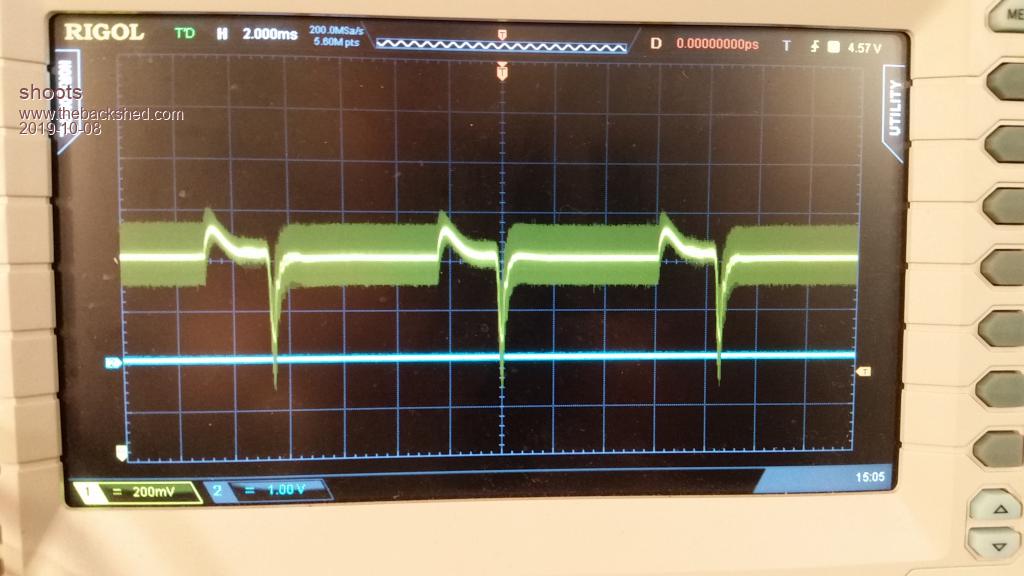

I am running an Explore 100 with a 5" touchscreen piggybacked onto it. I have a pressure transducer sending an analogue input to the Explore. No matter what I try I cannot eliminate the noise on the analogue signal. The noise is present on the supply rail and is then coming through the output of the transducer.
It is not present when I unplug the touchscreen. It is still there if I use a battery to supply the system so I am confident it is not coming through the power supply. Monitored at the supply rail the noise spikes down 0.5v. I have tried loading an image of it. It has a main period of approx. 8.5mS and the shallower ripple in the noise has a spike every 10uS.
I have tried bypass caps on the supply and on the back of the touchscreen board with no success. I have also tried a second touchscreen but with the same results.
Here is an image of the noise on the supply
Has anyone else had an issue with noise induced into the system from a touchscreen and any thoughts how to handle it please?

Posted: 08:26am 08 Oct 2019
The SSD1963 screens use a switching regulator to boost the supply voltage to drive the screen backlight. All you can do is add additional filtering on the explore100 and/or on the SSD PCB. Or, if the application merits it, remove the switching regulator from the SSD1963 PCB and patch in a replacement DC supply.

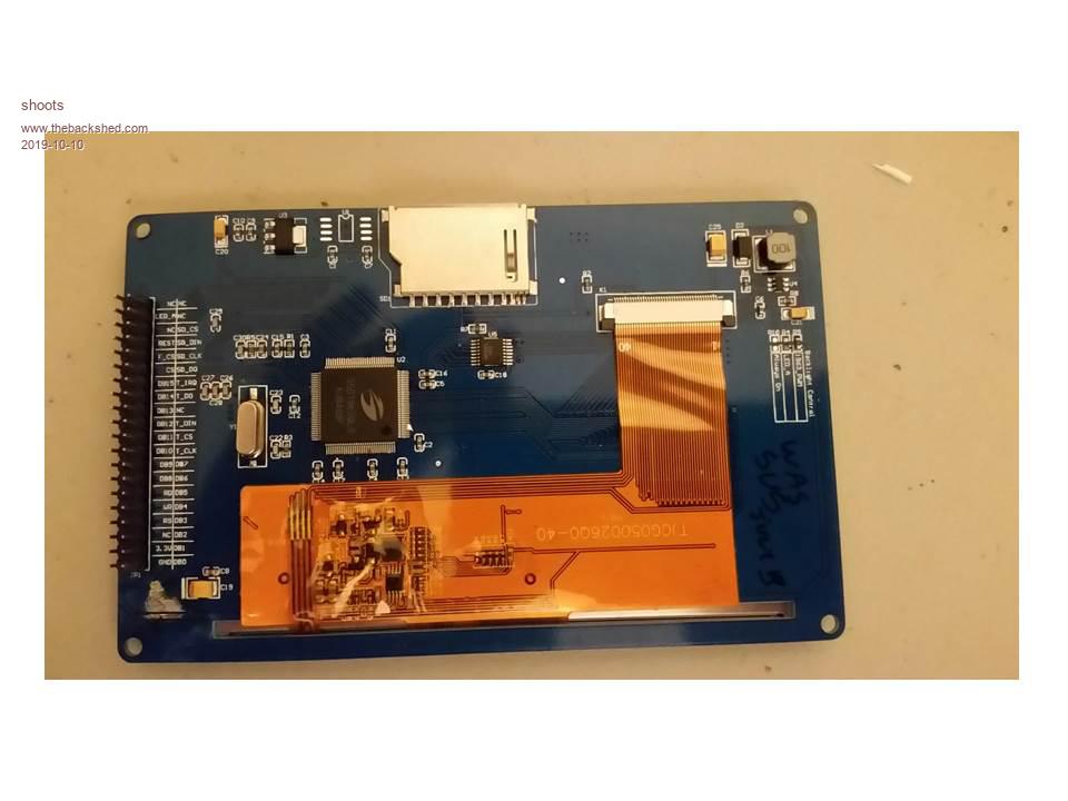

This is a pic of the rear of the screen. Has anyone had success with an alternate brand to this one? I would be wise to consider an alternate.

shoots

I will try both your suggestions. I did try a series of caps on the screen near the power input without joy (bottom LHS in the photo-since removed). I will try that as well as on the input to the MM. I will also have a look at applying bypass caps near the backlight boost circuitry.
Any ideas what the backlight voltage is boosted to on these screens? I suspect the boost cct may be at the top right. Will try and get to it tonight.

I have no idea about the boost voltage but you should be able to measure it.
Make sure you use a decent electro. at least a few hundred uF
