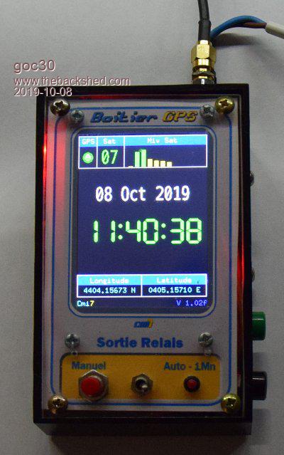

goc30
Joined: 12/04/2017
Posts: 435
Posted: 09:50am 08 Oct 2019
my proto box
