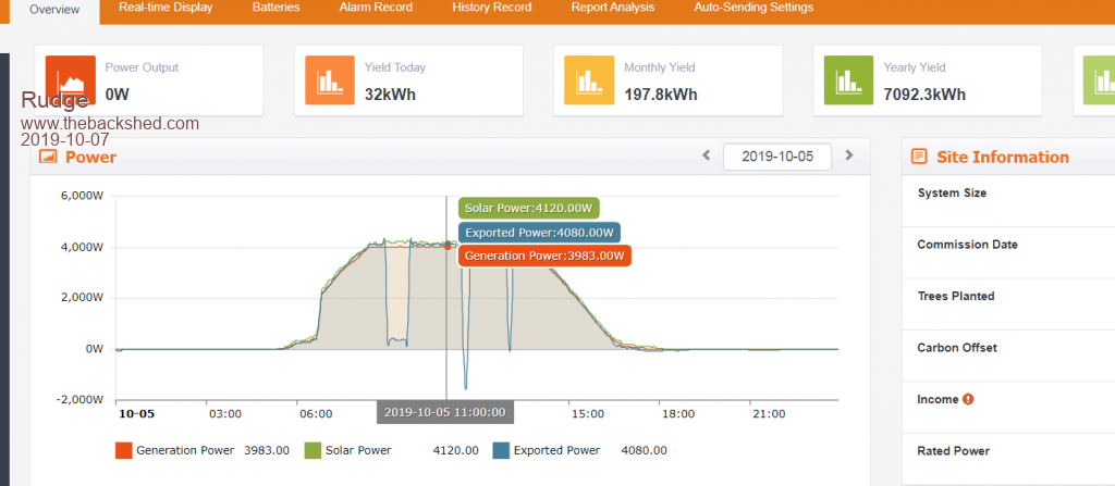

One thing I was going to say in regards to the Voltage relays was I had the perfect day for it today.

Re: New Build.  I had exactly these questions just three years ago.  Luckily I chose the solar PV option and my electrician added a simple $25.00 timer switch in the distribution box.  Now the H/W can only come on during my chosen hours of sunlight and for just two of us, mainly, it works a treat.  When we go travelling I just trip the breaker off and when we return I go to over-ride and have hot water within the hour.  I should have chosen a lower wattage element because sometimes the power used exceeds the solar at that point in time if a bit cloudy.  As was suggested above, heating for longer at a lower rate would be a bit better but quite honestly I can wait until the current element breaks.  This option far outweighs the cost of solar h/w plumbing.
I did not understand that the new sub-division we built in has three-phase at every distribution board, and nobody pointed it out.  My single phase inverter only shows the loads on the one phase, including the H/W, so I can't see the impact of the A/C and the hot-tub because they are on the other phases.  I am assured that my solar generated power is correctly accounted for even if it only feeds the one phase - perhaps someone can re-assure me.  Either way it would be nice to see the impact of the Aircon.

  Rudge said    My single phase inverter only shows the loads on the one phase, including the H/W, so I can't see the impact of the A/C and the hot-tub because they are on the other phases.  I am assured that my solar generated power is correctly accounted for even if it only feeds the one phase - perhaps someone can re-assure me.  Either way it would be nice to see the impact of the Aircon.
Do you mean your INVERTER only shows the single phase loads or your METER only shows the loads?
I can't see how any inverter could show loads, it would have to have all the current for that circuit running through it.... like a meter.
If you meant a meter, if you only have one, that covers all phases and the solar. If you have 3 Meters and another for the solar, that's Different..... and wrong.
Your solar should cover all phases.... Unless you have a bootleg system like mine which  has and inverter ( or more) on each phase for that reason.
I would have thought for a new Build 3 years ago you would have had a smart/ electronic meter and that would cover all phases and the off peak if you have it.
If you want to see individual consumption, You could have a small meter fitted on the hot water and the spa which I imagine would have a dedicated HD circuit as well.
The meters are only about $50 for a single phase and shouldn't be exy for a sparky to fit or if you are handy you can easy DIY it.
You could also fit the meters at the Hot water system or spa in a weatherproof enclosure if they are outside.  You can get them off ebay that have an Inductive coil you put ropund the active cable. The unit just plugs into the power but carries no load at all.  I have a couple of them and have found them to be surprisingly accurate and very handy. had one on my own HWS for a while which was very informative.... and scary as to how much power the thing could use!
You can get the meters off fleabay for around $25.

Sorry.  I should have said my 'Inverter Monitoring Software' which displays the Solar Power and Exported Power.  Here is a screenshot.
The H/W cut-in can be clearly seen, usually for an hour or so each morning and a couple of blips later in the day.

I can see what you mean.
A smaller element definitely would work better here to stop the draw going below the generation and costing you almost 2 Kw of power from the grid. Then again, if that's for an hour probably costing about .60C.
I know you can get 3 phase meters that have 3 CT's to go on every phase and will record and show the numbers for each phase like above and have wi fi or networked monitoring.
Last time I looked they were about $120 from memory.
You would certainly be pulling some power when you put on any 2 larger loads like AC and pool or AC and water heater. Even an electric stove if you had one would put you behind with anything else like the spa running.
Still, better to have the power you do than nothing.
