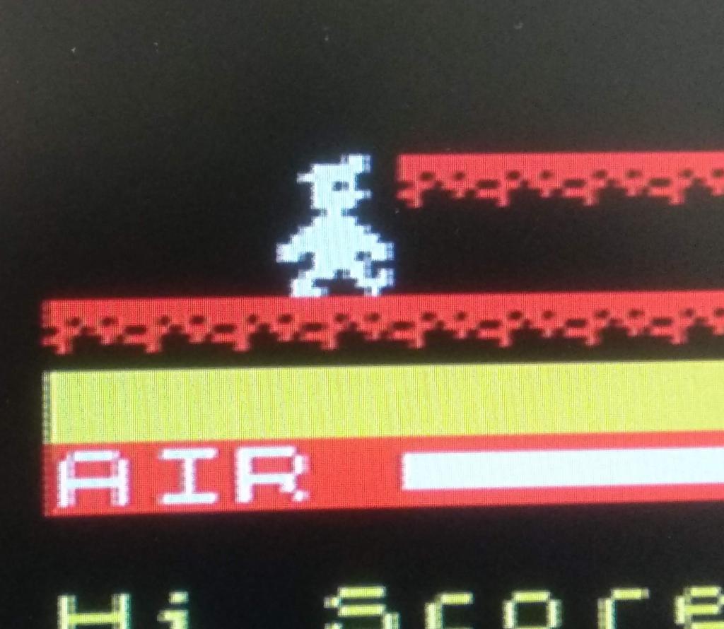

The image does not the crystal clarity I have come to expect from modern computers, is this to be expected? There is nothing I can sucessfully capture on camera but characters seem to have a very slight blur to them, more noticeable in Mode 4 than Mode 3. I guess the image is still probably better than I remember from an 8-bit computer attached to an old TV, but I'm wondering if it something I haven't managed quite correctly in the construction.
Any opinions/suggestions?

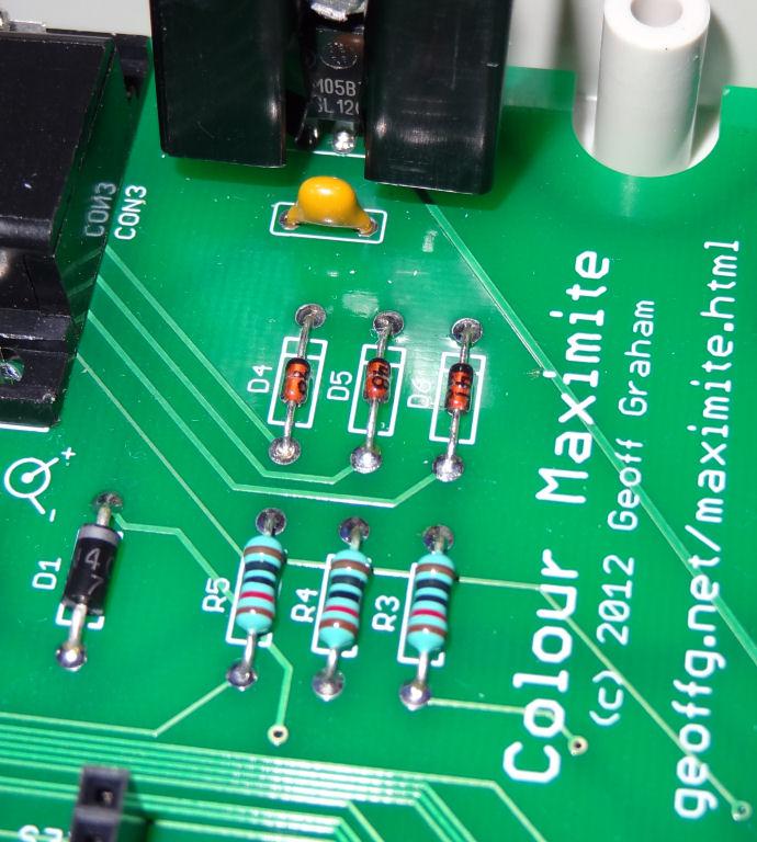

Are you sure you assembled the Maximite with the correct resistors and the diodes the right way round on the VGA output part?
The idea is that the red, green, and blue pins for VGA vary between 0V and 0.7V.  Because the CMM is only eight-colour, it wants those pins to be either high or low, and it does this by using relatively low value resistors (120-Ohm) with 1N4148 diodes that clip the maximum voltage at or below 0.7V.
If you use slower diodes then they don't switch fast enough and that results in a fuzzy picture.  If you've fitted one or more of the diodes backwards, then the voltage will be driven above 0.7V which is outside the VGA spec and also results in a poor picture.  The black bands on the 1N4148 diodes should be on the side nearest to the voltage regulator.
Also, it's easy to fit resistors with too high a resistance that will produce a feeble, dimly-coloured picture.

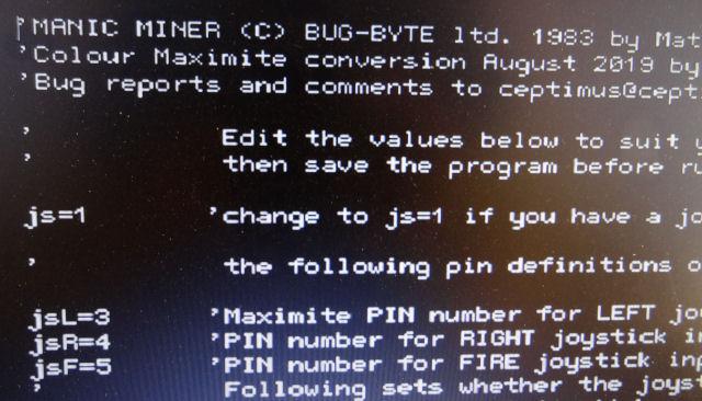

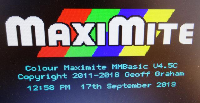

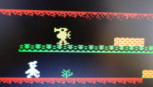

Here are some photos I just snapped of the screen.  This is with a cheap Acer KA220HQ LCD monitor.  I really should have wiped the dust off the screen first!

Your LCD has a very stable image, but when I say about the quality, we can see in the image below the irregular scaling effect:
Look in the M letter, you will see that the vertical lines are not the same width for the same letter in another position on the screen.
The letter X has the same problem, which doesn't have uniformity in the diagonal lines, and I sure that the same letter in another position will sometimes have perfect diagonal pixelated lines.
This is not a CMM bug, it's like I said before, it's just the digital display trying to scale a not standard resolution, and on an analog display, these scale effects don't occur.

I've checked the diodes and resistors, and I've wiggled the connectors to no avail, pixels (especially in Mode 4) still have a "shadow":
