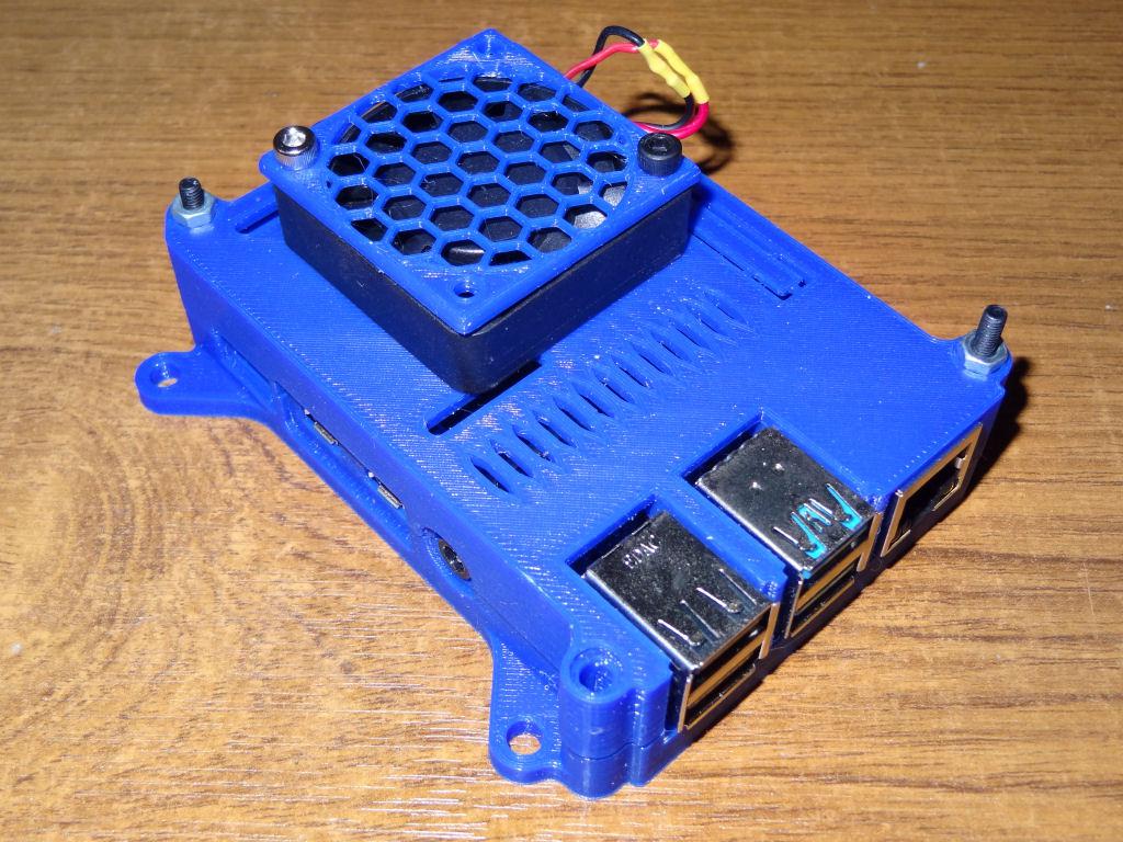

Posted: 03:59pm 14 Oct 2019
Sounds like a big fan for a little Pi!
I went for a little 5V fan that's powered via the Pi GPIO: 40 x 40 x 10 mm - it's not silent, but it's not loud enough to bother me.
I really should replace the all-thread plus nuts holding the case together with some proper fasteners.
What case is that ?
Neat looking .....

Posted: 06:59pm 14 Oct 2019
It's on Thingiverse: https://www.thingiverse.com/thing:1815268/files
Everything is there including the fan cover.
Only thing that wasn't quite right was that the stand-offs inside the case that the Pi sits on have their holes a bit too big.  The stand-offs and holes are perfectly positioned, but self-tapper screws small enough to pass through the fixing holes in the Pi are too loose a fit in the stand offs to tap properly.  I fixed that by plugging the holes in the stand offs with hot-melt glue, then drilling pilot holes in the glue and threading the self-tappers into those.  Epoxy glue would probably be better than hot glue, providing you wait for it to fully set before drilling it and fastening the Pi to it!
