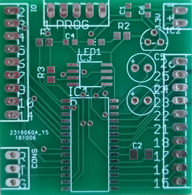

I am playing around with a layout for an Extreme64 based PCB. (very early stages)
As usual I am trying to keep this board as small as possible..
Due to the fact the VGA is not available on the X64 is there a need for the Mouse and keyboard PS2 connectors?
These are relatively bulky and it would be nice to not have them on the board..
I am after opinions as whether these are really useful on the X64 or not.. I can utilise the space for other items
Anyway I am interested in your opinions.

We all know my ability (or lack there of) to program so I doubt I could write code to test it.

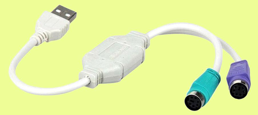

Re. The PS2, I am exploring a couple of other options (Piggy back plug in PCB) or header pins and a converter cable (prob using one of those 2 PS2 to USB cables and modifying it) as I am trying to squeeze everything onto a 50mm square PCB..

Posted: 08:23am 07 Sep 2019
agree with that.... PS2 blocks take a lot out of 50mm sq .

It doesn't matter anyway - whichever pin you designate as CS for it will get in the way of someones work
It was just a thought. My Mk5 mini controller board has space for one - I had the room and thought it was a nice touch - just in case.
This little board is a real workhorse - I use them everywhere - dead easy to build up and just gets on with business no problems. The use of a 78L33 won't be to everyone's tastes it is easy to "jumper" when provided with 3.3v on the input and  can work all the way up to 12v with a single solution and no hassles, plus I got stacks of them left over

PeterB

I most likely will scrap the PS2 connectors as they take up so much room, and use a header to gain connectivity if required, I might make a small daughter PCB that has the Audio jack and kb/mouse on it..
I have ordered one of these to strip down.
It would be easy enough to use the cables and terminate them at a header to match the main board..

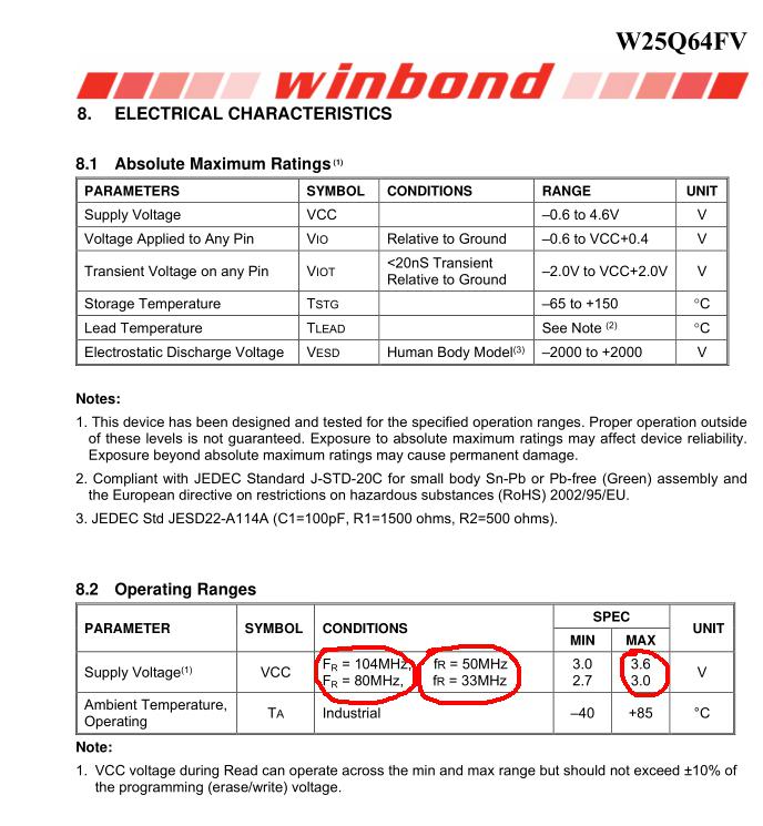

I have had a quick scan of the data sheet and I am a little concerned about the following specs.
I am yet to determine what Fr really means but if operating at 80MHz/33Mhz the max Vcc seems to be 3.0v
Hmmm... I am sure they work well but just a thing to ponder

Posted: 10:54pm 08 Sep 2019
I read that spec. as saying you can run at the higher frequency with the higher voltage supply.  This is quite normal. So you can run at a maximum of 80/33 (I guess they are the figures for the two directions?) with a 3-volt supply, and the speed limit increases to 104/50 when you have a 3.3-volt supply.
Posts: 2984
Posted: 12:17am 09 Sep 2019
Hi Ceptimus,
It possibly does mean that but I feel that it looks like it is in reverse..
It states the Fr as (CONDITIONS) so I read the Vcc being max 3.0v
Very confusing.. but some people apparently have this working OK..

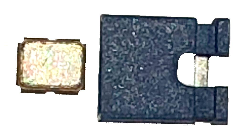

My MZ chip and 24Hz Xtal arrived today so I am just waiting for my TQFP-header pins adapter to breadboard a bit of the circuit.
That 24Hz xtal must be a pretty big rock...

Posted: 02:14am 09 Sep 2019
@Brian,
Actually, (Yes I know you were joking), I almost couldn't find it in its plastic bag.. It is a whopping  3.2mm x 2.5mm and was darn hard to solder some wires on to test it  in my X144 board. (yes it works fine even without the pin 1 mod).
This might be a challenge for someone to solder but then the 0.5mm pitch on the MZ is not going to be for home handyman solderers either. Flux will be a must.
Here is a rough as guts picture next to a 0.1" shorting link
Kind Regards,

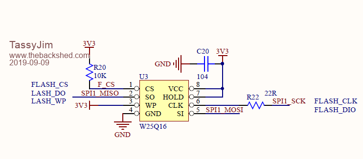

I have been playing with the W25Q16JV which comes on the STM32F4 board.
The data sheet is similar to the W25Q64FV.
This is the circuit for the flash chip:
Note the 3.3Vsupply and also the WP and HOLD pins tied to 3.3V

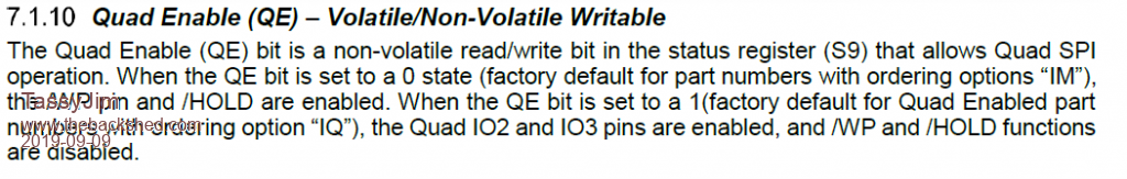

The chips supplied on my boards are of the variety that default to QUAD ENABLE being set!

I think you will be safe with 3.3V
