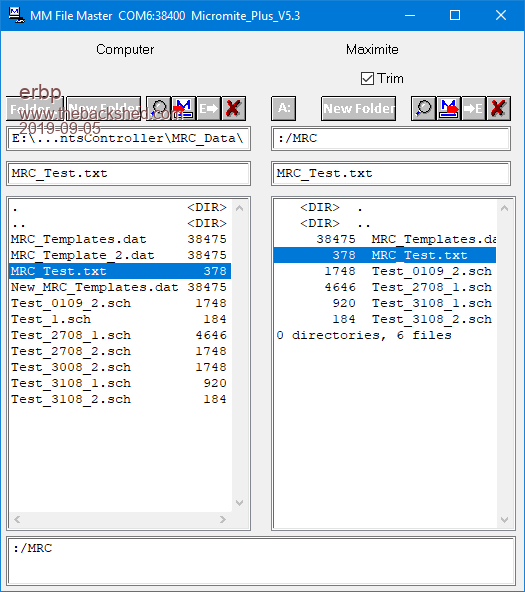

I then used MMEdit File Manager to transfer a second copy of the test data file to the SDCard. The below screen shot is prior to the transfer - note the size of the MRC_Test.txt file is showing the same 378 bytes in both the PC and MM panels.

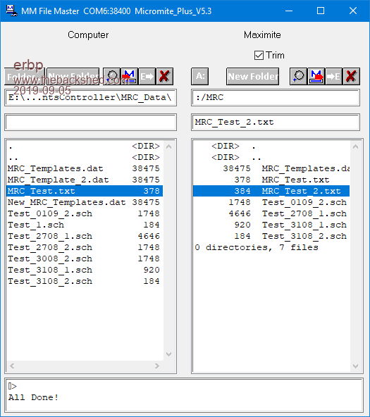

I then uploaded the file from PC to SDCard as MRC_Test_2.txt - following screen shot shows that the MRC_Test_2.txt file size is 384 bytes on the SDCard!!

Note the 15th record has appeared containing 5 0x1A bytes.
This would appear to be the XMODEM "filler" bytes inserted in the final block of the transfer to make the block up to the 128 byte size used by XMODEM. Note that the new file size of 384 bytes = 3 x 128.
