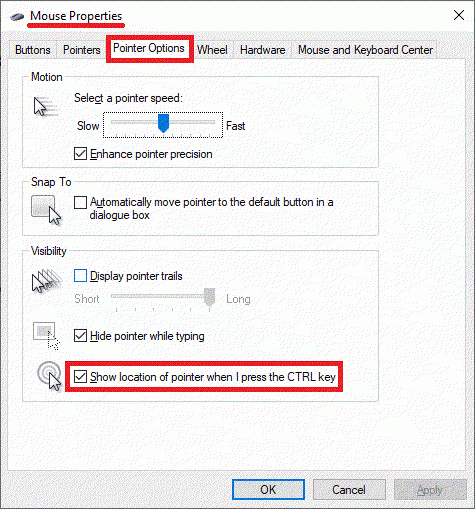

if you press ctrl-3 the boarder colour should change from black to white. this indicates reversed video is on (black maps to white, white maps to black). this is not a persistent setting. ctrl-n where n=0..9 are all undocumented features intended mostly for testing purposes.
you can enable mouse pointer location in windows here:
as far as i am aware, this works in all versions of windows from XP upwards. when enabled, just tap the ctrl key to cause a circle to flash for half a second around the mouse pointer.

Mouse pointer location information, I recognise the information.
Got stuck again with the pointer focus. ie can't understand why I can't see characters in GFXterm, the cursor is blinking so it must be active?? No I realise what it is that throws me off track. The blinking cursor, that it blinks does not mean the mouse has focus. That is a tricky one.  ZZzzz.... rime here

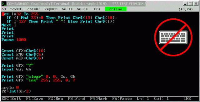

   give this test version a try:
GFXterm test (2019-09-04).zip
it shows a very 'unsubtle' icon on the screen when the application does not have focus:
rob   :-)

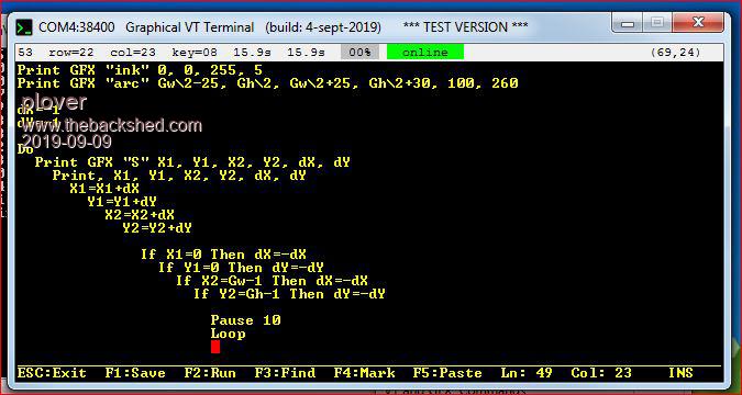

Thank you very much, was jus closing for the night when I noticed the new version. I was a bit absentminded and just downloaded the zip file, forgot to switch off AVAST before starting up, the result it started up for about 5 seconds before AVAST woke of the the fact that this was a 'very rare file' and snatched it and sent it for testing.
Suggesting it will take 65 minutes.  Well I will have to test it in the morning. From your picture I believe I am going to enjoy this.
One of those days when things just don't go the way you hope so I did not get around to look at anymore on the GFXterm.
Hmmmmm, starting to wake up a bit. Turned off AVAST for 10 minutes and THEN started up the GFXterm with focus alert. Yes I like it very much, it diapers immediately when focus returns to the window.

The focus alert absolutely great for me. Even before I get around to hit the command line I know if the focus is away or already in place, a real treat.

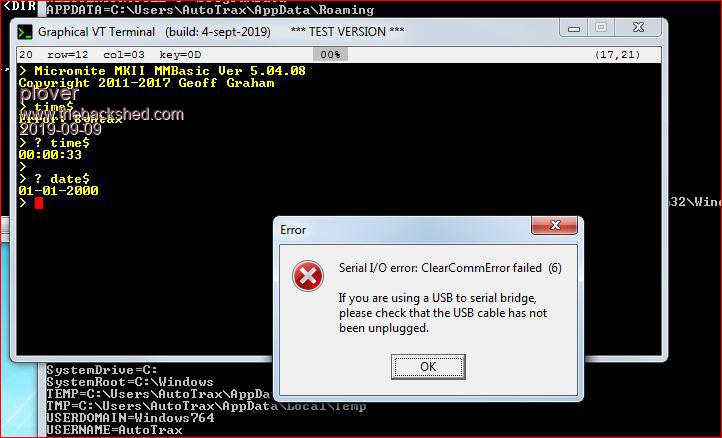

Have been away visiting family and took a win7 laptop for a bit of relaxation. I took also the E-28 thinking I would be able to check out some items that has me confused.
Well I found out that the GFXterminal failed to connect to E-28 on a Win 7 32 bit laptop. Stumped me because I run a win7 64 bit desktop and this does not have trouble. However that machine has been used to run MMEdit some motnhts/year ago and I may have installed driver at that time. I do not remember.
Device manager revealed the VID and PID
VID04D8   PID000A
I know it is something CDC, USB to serial coms interface
Internet search seems to give me a MS file needed 300 MB file for a 15 kB file??
A bit painful anyone got a better solution?  I am likely to have missed something like so and so supplied a driver? As I am home again I will not need it for another 4 weeks so I will put this aside for the moment.
I would like to return to the question of using console port on the MMBasic. I think I have figured out at last that while having a terminal connected the connection via the command line will be able to interpret a subset of the MMBasic commands?
Micromite MKII MMBasic Ver 5.04.08
Copyright 2011-2017 Geoff Graham
> time$
Error: Syntax
> ? time$
00:00:28
> ? date$
> ? DATE$
01-01-2000
> ? date$
01-01-2000
But following being MMBasic commands do not respond on the command line.
? MM.DRIVE$
> ? MM.FNAMES$
How many MMBasic commands and what are they that responds in command line ?
