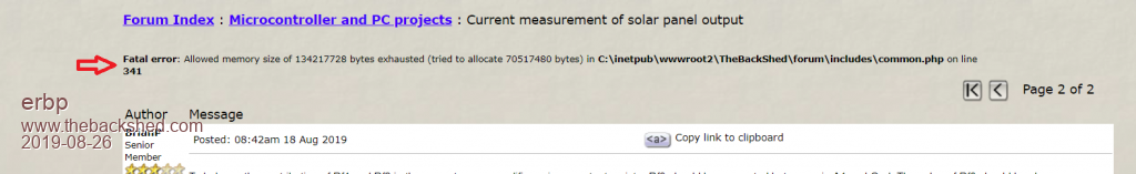

Posted: 08:46am 26 Aug 2019
When I try to go to the last post in the  "Current Measurement of Solar Panel Output" thread I get the following error displayed at the top of Page 2:
Phil.
Posted: 10:40am 26 Aug 2019
Guys I'm aware of these issues. No need for a new thread.
erbp that current measurement thread is broken, one of the replies is malformed, someone went to quote another and they deleted the trailing ] character in the {QUOTE=NAME}. I will fix the thread but I want to stop this problem happening again first.
Posted: 11:21am 26 Aug 2019
That thread is fixed.
Explanation of what the problem is. I'm replacing the [ with { for this or the forum code will get confused.
Someone quoted someone else, but they deleted the trailing ], so instead of {QUOTE=FRED} Blah blah, we had {QUOTE=FRED Blah blah.
The code looks for {QUOTE=, and then for the first } after that. Between the {QUOTE= and } is the members username. It didnt find the }, and as it was stuck in a loop until it had processed all {QUOTE= 's, it quickly ran out of memory and raised that fatal error.
How to fix it? Ideally the code should work out where the last } should have gone, after the member username, but how to detect the end of the username? A space? Nup, some usernames have spaces in them! The only way I could think of was, if the code could not find a } after 50 characters ( the maximum length of a username ), then give up and drop the username altogether. It treats {QUOTE=Fred Blah blah, as {QUOTE=}Fred Blah Blah. That way the formatting may be a bit off, but the code wont crash.
In the end, its up to members to be careful with the forum codes, these need to be structured correctly for the forum to display the posts correctly.
