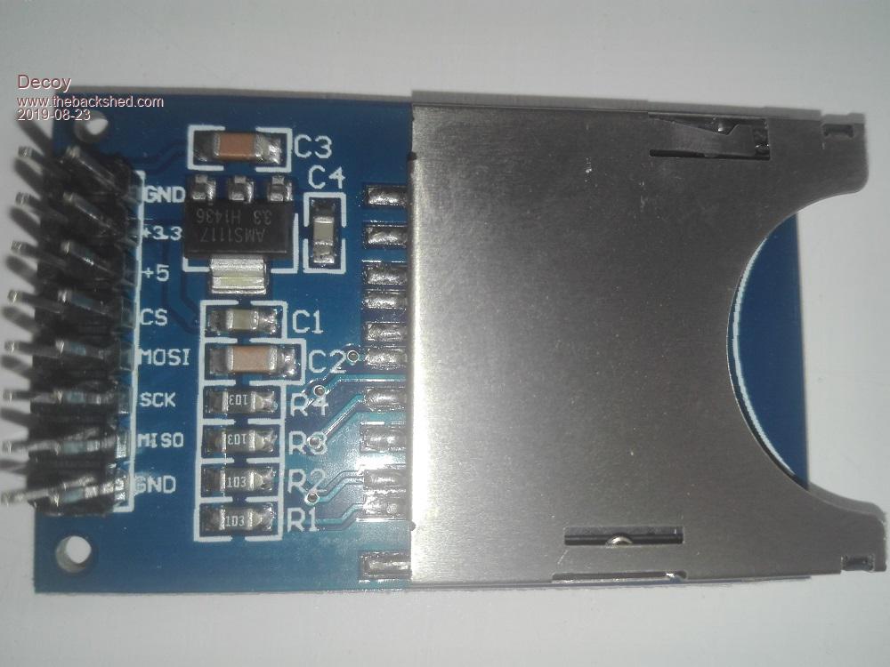

I have ordered several SD-card readers, but this one (picture) arrived first. I have tried connecting it, but I cannot get it to work.
Any advice on how to connect the leads between it and the UBW32?

Try
GND - GND
+3.3 - 3.3V
+5 - don't connect
CS - A1
MOSI - F4
SCK - F13
MISO - F4
GND - GND
You probably need a link from the UBW32 GND to its D5 pin so it thinks the SD card is present - I can't see the pins for the card present switch on that adapter.
You can use the Files command to list the SD card contents: just type files <enter> at the command prompt.
Then to change directory (folder) - say to a folder called 'name' you use Chdir name
To go 'back up' a level you use Chdir ..
Edited 2019-08-23 05:51 by ceptimus

Yeah, might be better to wait. I was wondering about the many resistors on this SD pcb. They don't seem to present on the other SD pcbs? Maybe I could solder directly to the pins on the sd card holder...but there seem to be 10 pins, not 9?
I can feel that the SD card adventure will be an exercise in frustration
Thanks!

My home-made adapter that I photographed and put in an earlier thread also has the resistors.  They're just pull-up resistors to 3.3V about 20K
I'll try linking to the image of the circuit here
[edit] cropped the image down to a reasonable size [/edit]
Reading from left to right the connected pins on the SD card are
chip (card) select
data in
ground
3.3V
clock
ground
data out
If you want to make a home-made micro SD card adapter, all you need is a spare micro-SD to SD adapter, and you can solder direct to the pads that normally contact inside a 'real' card reader.
Edited 2019-08-23 07:21 by ceptimus

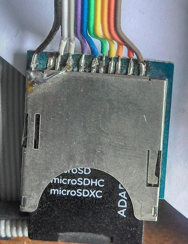

Posted: 04:22am 23 Aug 2019
There were a lot of power related problems for some users.
Some used a 3.3 ohm (?) resistor in the supply, others found a direct connection was better.
I would use the 5V instead of 3.3V. That uses the on board regulator and should give a better regulation.I will check my wiring when I get back to the office but I am sure that I took the wiring straight from the CMM circuit diagram.
Do you have a few different SD cards to test with?
Decoy
Joined: 02/08/2019
Location: Denmark
Posts: 109
Posted: 02:30pm 23 Aug 2019
Thanks!
I have other SD cards en route! :)
Posted: 01:41am 24 Aug 2019
OK
I have had a chance to look at my UBW32 setup.
I think it started out like your module and I cut the extraneous components off leaving a bare board. I like my bandsaw.
The connections to the UBW32 are 75mm long.
I have used 'complete modules on other boards without issue.
I haven't added any pullups but they shouldn't be an issue.
The 3.3V supply is directly connected to a fairly hefty regulator.
Note the earthing link between the case and the pin 4th from the left. It connects to GND.
I must have had a reason for doing that!
Be warned - there could be holders with different pinouts, just to make life interesting.
Posted: 03:51am 24 Aug 2019
To add to the above:
  Quote  Brown   NC
Red     A1   Card enable
Orange F5   Data to card
Yellow  GND
Green   D5   Card present
Blue    3.3V
Purple  F13  Clock
Grey    GND
White   F4   Data from card
Black   D6   Write protect

could you show some explicit pictures how you´ve exactly done it, sometimes troubles are easier to spot that way.

Still waiting for other SD-card holder, but here is a picture of my former attempt, made with help from Jim and requested by Poppy :)
This is connected to the UBW32 pins that Jim suggested, no dice.

Have you got anything connected to D5 and D6 with that device?
If you have, you should see those pins floating high (about 3.3.V) when no SD card is inserted, and they should be pulled low (close to 0V) when you insert a normal SD card (one where you've not slid the little 'write protect' switch to the protect position).
You can also disconnect any wires to D5/D6 and just link those two pins to GND - that way the Maximite always thinks a write-enabled card is inserted, even when it isn't.
Another reason that board might not be working is that even though you've wired direct to the SD card pins, the other components on the board are still connected - so the pull-up resistors will be kind-of linking the SD pins together rather than pulling them up - because there isn't any 3.3V on the common side of the resistors.
If the D5/D6 thing is already correct, I would next try leaving your card as-is but additionally connect 3.3V to the board pin marked 3.3
Edited 2019-08-28 04:32 by ceptimus
