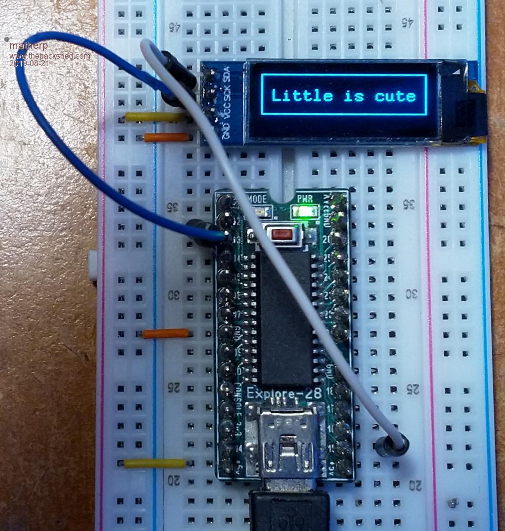

Posted: 08:47am 22 Aug 2019
  Quote  nothing on the screen, shoud I type before some specific command to enable the display?
No, should just work. I tested on 128x64 and 128x32 as pictured using a 28 pin MM2. Note 1.3" I2C versions are wired incorrectly and don't work. I'm not aware of any faulty 128x32 displays.

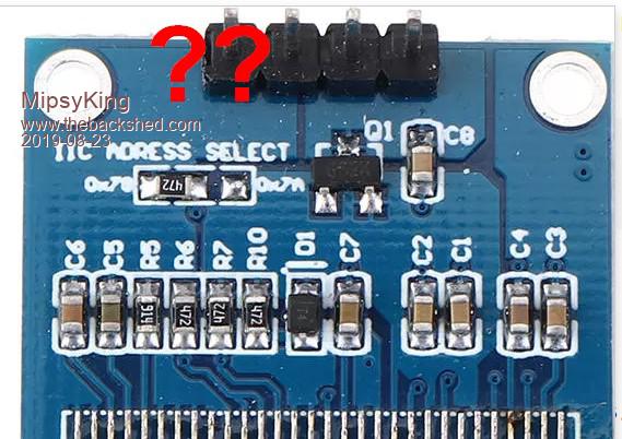

Posted: 04:28pm 22 Aug 2019
Ok, all working now!    The problem was the back of the display: there is a configuration resistor soldered on 0x78 and the alternative is 0x7A. So I configured your listing for &h78... but it was misleading because everithing started to work when I had the idea to simply dont touch your default setting (so the the real adress is &h3C ?) . I dont know why they wrote such numbers, if is not true...
Posted: 07:01pm 22 Aug 2019
  Quote  I dont know why they wrote such numbers, if is not true...
I2C devices have a 7-bit address and the 8th bit defines read or write. There are two conventions, one treats the addresses as 0-254 in steps of 2 and the other 0-127 in steps of one. MMBasic uses the second, your display is using the first.
hex 78 / 2 = hex 3C
