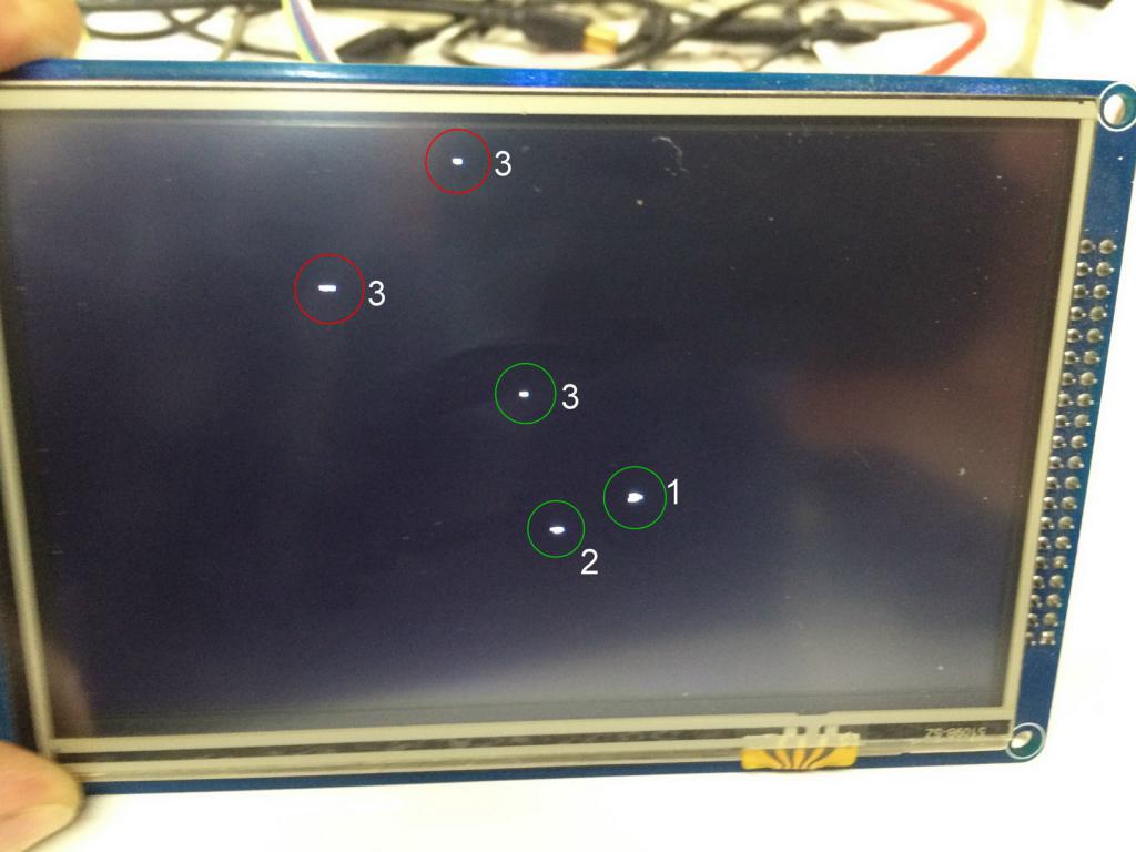

A bit annoying after a while, so I thought I'd try a GUI TEST TOUCH command (Had to run it many times to get an uncluttered result)
Here's a picture of what I came up with -
The green circles are actual touches and are numbered in order of the touch. The red circles are my rogue touches that happened with my 3rd green touch. No way did I touch those areas, so I'm wondering what my problem is... I can't tell which order the touches happened in, so I'm just guessing that where I actually touched was the first.
My initial thought is that I have a hardware issue... MAYBE related to my ribbon cable (capacitance or inductance for example - maybe even the length of the wire) and slowing down the touch IRQ, but that's only a guess.
Any thoughts from the brains trust?

I know from experience that I had all kinds of issues with touch and display with ribbon cable, especially longer cables, but even short socket to socket 50mm apart connections can cause problems. Can the clock speed be dropped on the E64? If so, does slowing the clock speed down make any difference at all? Sorry can't be of more help.

Yes, the parallel bus to the LCD runs quite fast, and long wires will have an effect here. You should try to keep them as short as possible.
When you do the GUI TEST TOUCH, keep your finger on the LCD, and draw a line with your finger. Does the LCD draw a line to follow your finger? If not, either the calibration is wrong or needs to be done again, or you might have jitter on your data lines from the LCD to the E64.
You can slow the E64 down just like the E100 - it is exactly the same MMBASIC, except that the 100-pin chip has more I/O pins.
So, I would first try issuing a CPU 80 to slow the CPU to 80MHz and see if that helps. Keep slowing the CPU up, till things behave. This will have the effect of slowing down the LCD drawing time, but C'est La Vie for your current setup.

I get a jittery line as I trace my finger across the screen (depending on the speed I trace across it). I'm pretty sure the clock is a 20meg, so it's not the fastest car in the race
