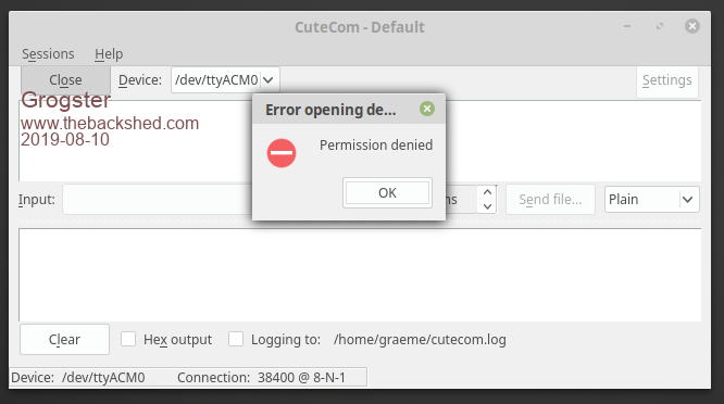

I did find CuteCom, and installed that, but for some reason, it won't let me talk to the COM port.
If I plug in an E28 module, Linux sees it there at /dev/ttyACM0, but if I select that device and 38k4 baud, 8N1 and try to open it, Linux replies with 'Permission denied'

Serial ports are off limits to users outside of the "dialout" group. This should fix you:
https://askubuntu.com/questions/210177/serial-port-terminal-cannot-open-dev-ttys0-permission-denied

@ SimpleSafeName: Thanks very much. I added myself to the dialout group, and I now have access to the MM console.
