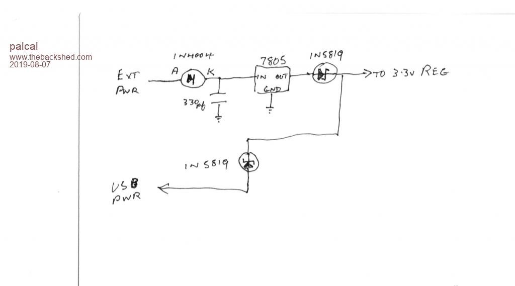

It is in series with the output of REG1, I think it has something to do with using USB power.
palcal
Joined: 12/10/2011
Posts: 2052
Posted: 09:29pm 06 Aug 2019
Not good but you get the idea?
twofingers
Joined: 02/06/2014
Posts: 1773
Posted: 09:34pm 06 Aug 2019
ah, it should decouple the two input ways (Ext. Pwr and USB Pwr)! Makes sense!

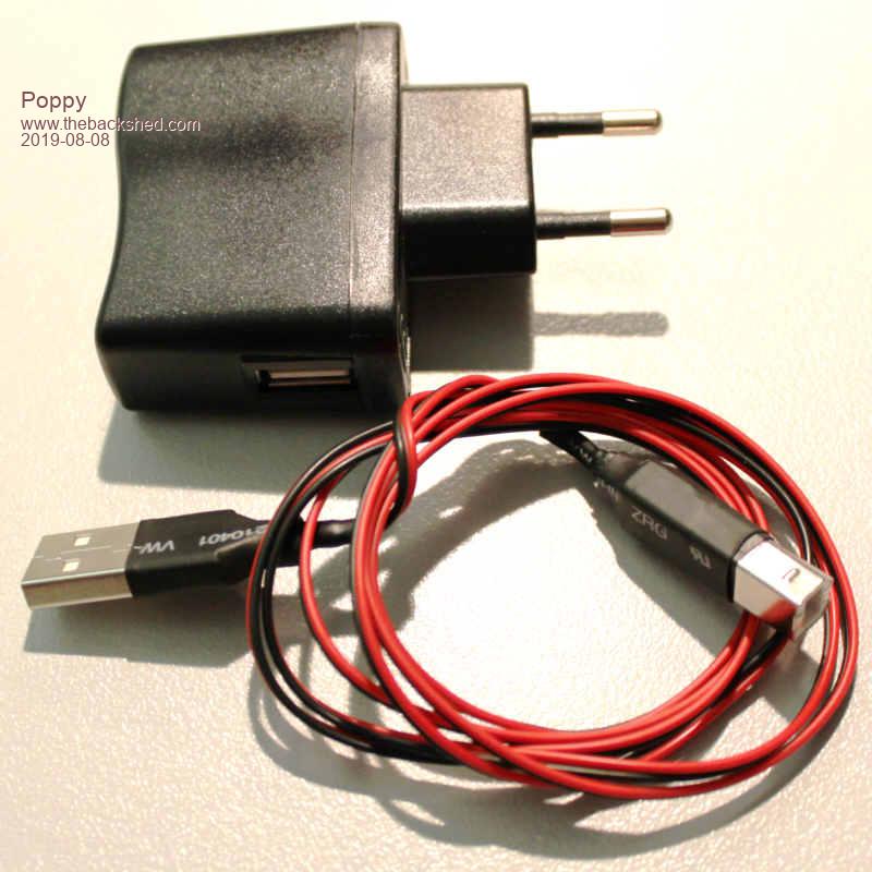

Thanks!
Currently I am just powering my CMM through the USB by an diy USB-A to USB-B-Cable, very flexible and a common USB-Power-Adaptor.
This works best for me not getting anything hot.

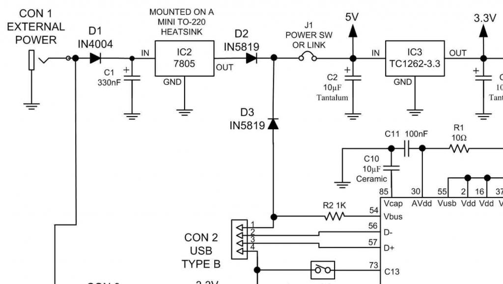

Posts: 10043
Posted: 10:50pm 08 Aug 2019
Hallo Poppy.
D1 prevents damage to the board due to reverse-polarity applied to the DC socket, D2 and D3 form a simple diode OR gate, so that in the event of being powered by external DC, D2 will pass the power, and D3 will block it. When powered by USB, D3 will pass the power and D2 will block it.
The idea is to prevent the external DC being fed back into the USB port 5v rail when powered externally, and to prevent the USB 5v from being fed back into the OUTPUT of the voltage regulator(not good!) if you are using USB power.
