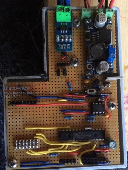

Here is my attempt at a better mouse trap using an MX170 and a few other recent TBS discoveries.
The time for the VT2500 to restore vacuum decreases as the cassette get fuller, until it will no longer attempt to restore the vacuum and it needs to be emptied. An ACS712 current sensor is used to detect when the vacuum pump is running.
The length of time the pump runs(last 16) is displayed as a histogram on this
ST7789 240*240 IPS Display so the decreasing run times can be seen and the emptying time predicted a bit better.
The last 16 runtimes are stored in this little RAM/EEPROM discovered by Lewis and coded by Jim. It ensures that the data is not lost when the power is switched off, and the previous usage is remembered.
47L04 a 4/16 Kbit SRAM with EEPROM backup

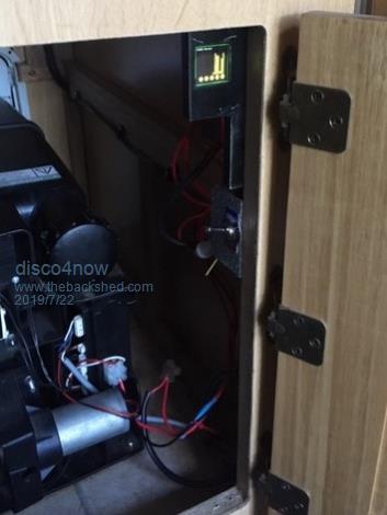

The remote button
The display
Installed in the cupboard
The hardware at the back of the screen.
