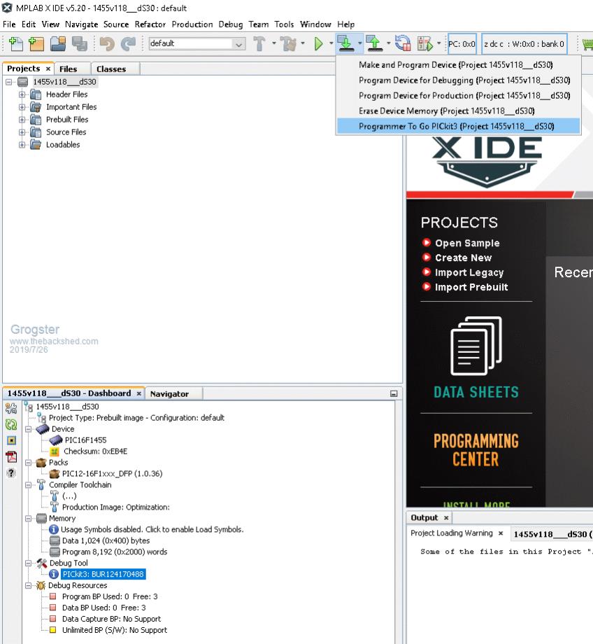

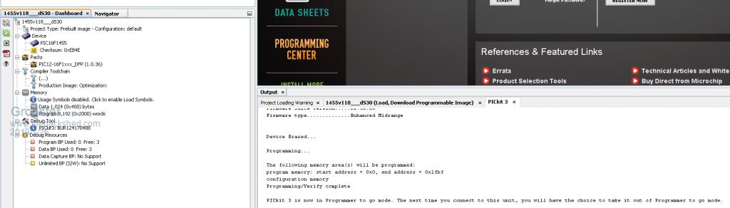

Posted: 12:17am 26 Jul 2019
Yep, a couple of clicks is all it takes in IDE:
1) Start IDE
2) Open existing project(the 1455 HEX file)
3) Point to DOWNLOAD icon, click the little down-arrow
4) Select Programmer To Go PICKit3
As soon as you select that, the image is loaded onto the PK3 and it is placed in PTG mode, which is indicated by blue ACTIVE LED on the PK3 blinking at you.
Now, to try this out on a chip....
