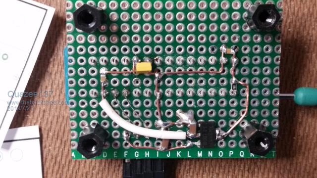

Wired this up last night on a piece of perf . surprised it went so easily

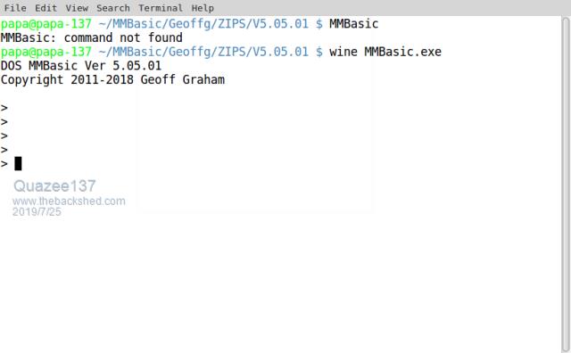

Havent been able to run under linux. Dosbox does indicate it needs Windows. Wine doesn t like it either. I would have spend more time on it if the dos version had some elementary form of graphix.
Quazee137
Joined: 07/08/2016
Posts: 603
Posted: 09:01pm 24 Jul 2019
Volhout Thanks for trying too. I tried a few ways still no luck.
Funny thing I created a folder and put MMBasic.exe in it.
then opened folder in a terminal
then type wine MMBasic.exe
I get this
I can ^C and it responds moving the > down a line. But no other keys work.
So near but so far away. Other ways to do the program but this just
seems right. With SYSTEM command-line$ MMBasic could be like a bash/bat
doing the bit handling and passing the file out to Pic32Prog
I had a pickit3 but never got it to work so I gave it to a student who has

rob I cant search the forum our talks on GFXterm. But I think there was a font
thing that you fixed so I could see the text. Now wondering if that is why
I do not get text in the above image.

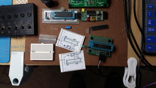

Also something with some options set as theses should be in the final
hex file.
Rob I used the bridge to connect to a zif'd 170 board to read the three files.
It's also the way I put MMBasic on the 60 chips. Then used the zif one I
posted to upload the basic program.
It was when I made the usb to zif that got me thinking of using Pic32Prog
to read the preset up chip and do MMBasic + program + options for the rest.
