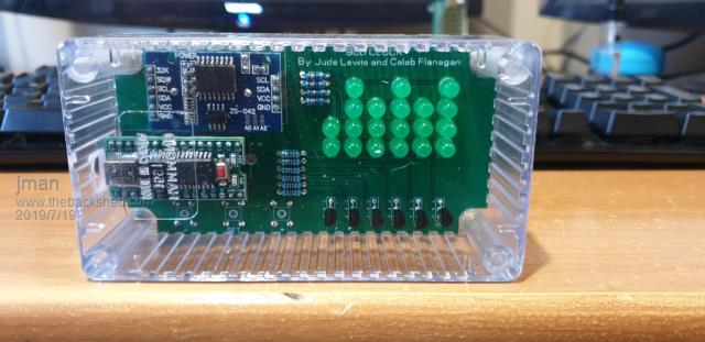

I thought I would share this little project.
Some kids from the local school wanted a tech project for school and a Binary clock seemed a goods fit. This was a great introduction to MMBasic as they have been learning PicAxe Basic at school the transition was not hard.
The kids built their own clocks (Soldering etc..) so the finished item is one that they made themselves .
Thanks to Grogster for the PCB design and to Westie42 for the PCB manufacturing.
The attached file has the necessary files and a link to the clear case from Element14
Needless to say we have some pretty proud school kids :) and hopefully some more MMBasic users.
