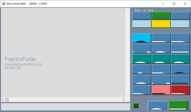

your program looks a little weird to me:
Probably it's because I have to set a text size of 175% because otherwise the font on this monitor is too small...
Frank

Posted: 07:36am 16 Jul 2019
The top two buttons towards the right, Green and Blue, these set the Text Size. Green for the Receive buffer and the Blue button for the button text. Like I said it was just thrown together, you should be able to adjust them as they use windows font dialogue controls.

Posted: 08:19am 16 Jul 2019
FYI I just set scaling to 175% in Win10 and it displays fine, although nicer with the button font dropped back slightly using the button I mentioned. There are custom settings in Win10 that go way above 175% though.
Mike.
EDIT: Actually, it looks like you have another setting wound way up that changes control fonts?
EDIT2: I went in to "ease of access" and set everything to as high as it would go and the program still rendered correctly.Edited by KeepIS 2019-07-17

Hi Mike,
it works now! The button text font size was set to 108 and the Receive buffer font size to 1425 by default...
After I set both to 18, everything's okay.
However after a new unpacking and starting the values are again on 108 and 1425...
Thanks for your program!

Thanks Frank, It looks like some localisation thing with those two default fonts.
If you happen to download an updated file at any time, just overwrite the old file and the saved settings including font will be applied from the setup file "Port.INI", if it's missing or deleted, it will be created with defaults at first run, as it's a text file you can see the default font sizes are actually set at 9 and 14.
