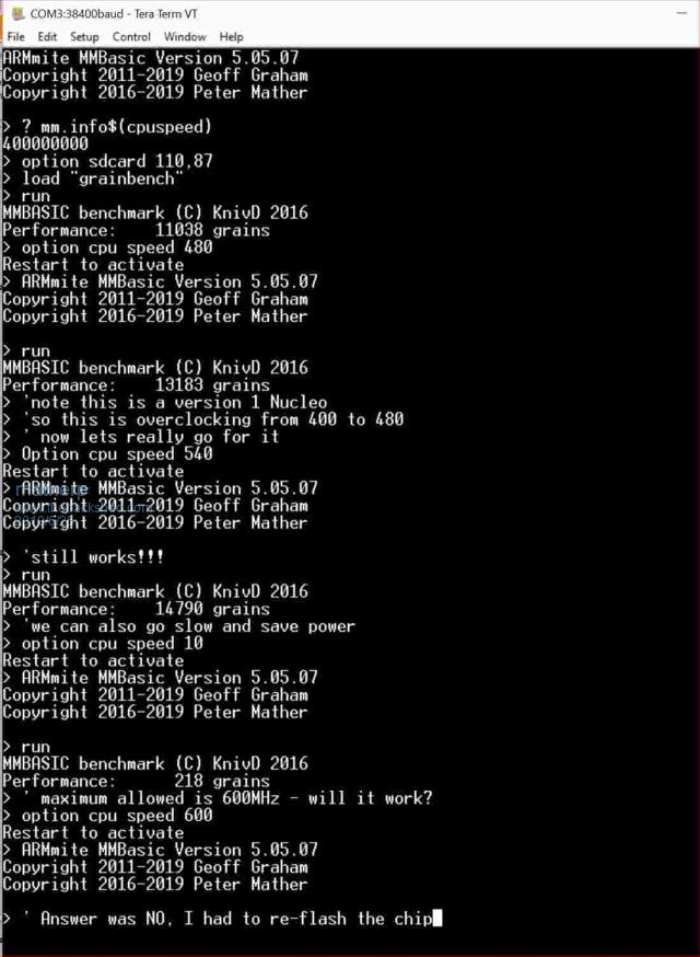

Note: If you overclock and the processor doesn't run you will need to re-flash. Other ways of resetting can't work in this case. The test above was run on a V1 Nucleo so only specced for 400MHz but ran fine at 540MHz!!!

Well done Peter,
How you find the time to achieve so much is bewildering!
Obviously the comm port serial data rates will not be affected?
It will be interesting to see how fast the 480Mhz chip will run.
The chip is likely to overheat and fail, one would presume?

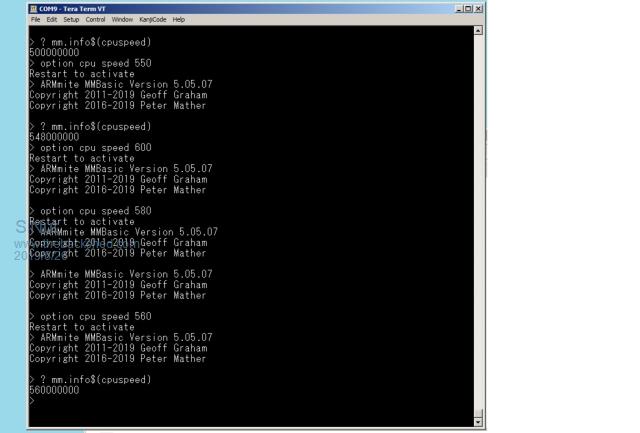

Peter, thanks for the updated firmware with ability to change CPU clock rate on the ARMmiteH7.
I can push the clock rate on my NUCLEO-H743ZI2 to 560MHz. However it is does not boot at 580MHz or 600MHz.
-- Gurbir
