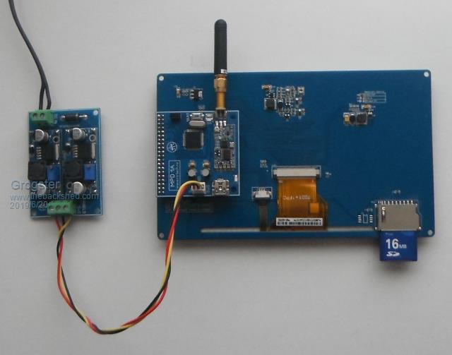

3v3 and 5v connected to 7" panel, via two external buck-converter modules. I will upload some photos shortly, of how I have everything connected.
EDIT: Here is the photo of my arrangement:
The MM+ board talks to the 7" LCD, and the PSU on the left of the image takes a 12v input and provides a 3v3 and 5v supply to the MM+ board.Edited by Grogster 2019-06-21

I tried a brand-new 7" LCD on this just now, and exactly the same problem. Changed 100uF caps just above the 3-way connector on the MPD board, to 1000uF 6v3 thinking perhaps there was some kind of voltage-drop issue, but that also did not help.

The fact that GUI RESET LCDPANEL works suggests that the Micromite is powering up before the SSD1863... something to do with the power supply sequencing perhaps?
You could delay the Micromite startup with a capacitor on MCLR but probably the simplest is to just keep using GUI RESET LCDPANEL.

@ Geoff - Yeah, I would have thought so too, but both the LCD and the MM+ are being fed from the same 3v3 supply. The 5v supply, is only there for the HC12 and the 7" LCD backlight - the "5v" pin. For whatever reason, the manual reset totally fixes the problem, so I am a happy chappy.
