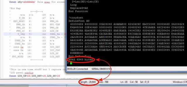

I have had similar stuff uploading using AUTOSAVE. The F4 we all seem to be playing with has a really nasty USB Serial thingie built in and when I do my usual thing of pasting in from Notepad++ I lose great chunks on anything bigger than about a K... OK for small stuff.
First time I ran I got some weird crap on a prog that is working fine on other platforms and does nothing more exotic than decalre some fonts... then I saw it was only 667 lines long instead of the 1300+... had a bit of a play and dumped the autosave method on it. I use the SDCard to transfer progs but no-where as quick as F10.

UPDATE:
Still the same. Decent Nokia cable no issues with anything other than F10
checked the speed (despite it being moot) and it was 38400, dropped it to 9600 as a test, same results... the actual data transferred seems to vary a bit - first test @9600 got 5987 bytes
doesn't really matter though.
