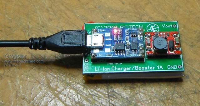

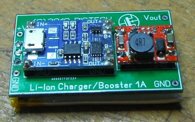

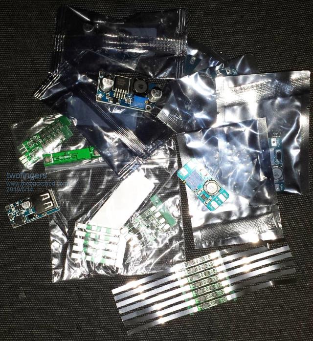

Howdy folks.
I whipped this unit up out of cheap modules from AliExpress and eBay.
I designed it to be a simple and cheaper alternative to using recharageable 9v batteries, and it is ABOUT the same size as a standard 9v cell.
It is SLIGHTLY larger though, but still quite small and includes fully automatic charging module, which is then coupled to a small boost-converter module, and the final output is 5v. Load can be up to 2A, but I am derating that back to 1A just to give me a little headroom. I have had 500mA load on this for several hours no problem, but more then that at 100% duty, and the little boost-converter gets quite hot. I never need anything like 2A @ 100% anyway, as this is designed as a replacement for some battery powered things, so the normal current consumption is much, much less then that.
The host PCB(green) holds the charger module, which is based on a TP4056 1A Li-Ion battery charger IC. The module I am using also incorporates under-voltage protection, and conveniently has a micro-USB socket at one end, so charging the battery is as simple as plugging in a suitable USB cable. The charger module has two LED's on board, one is red when charging, and the other is green which lights when the battery is charged. The red one goes out when the green one lights. These signals could easily be harnessed by the MM circuit, to know when the battery is on charge, and/or when it has finished charging.
The boost-converter is designed to be connected to a 3.7v battery, and to provide 5v output, and is based on an MT3608 boost-converter IC. This is ideal for feeding into many MM circuits, as they also have on-board 5v-to-3v3 regulators themselves.
The charger modules I used were theese ones.
The boost-converter modules I used were theese ones.
The batteries I used were theese ones.
There are a plethora of different size 'Silver-bag' Li-Ion batteries available, and the little green host board setup could be used with any of the bigger batteries too if you wanted. The charger module limits the charging current to 1A.
If anyone is interested in the little green host PCB, let me know on this thread. I already plan to add some extra pads along the output edge of the board, to route the LED signals from the charger module via some short links, so that a simple 4-way Dupont wire can provide power and charger state signals to your MM project.

Very nice indeed! Can you charge the battery while under load like ups style?
Posts: 10115
Posted: 12:50am 13 Jun 2019
Yes.
With a 570mA load on the 5v output, the red charge light comes on and the battery voltage is still sitting at 4.15v which is pretty much exactly right as the nominal is 4.2v.
EDIT: Efficiency of the boost-converter gets worse the more you load it up. This is kinda expected with the inductor on-board being kind of generic in value to suit middle-of-the-road kinds of use. Output voltage drops to 4.85v with 570mA load, but is back to 4.95v with a 300mA load.
Considering this is for battery-powered use, you would not be running 100% duty-cycle, so while this is showing a little lag when you load it up, this is not the normal way I would use it anyway.
You could probably fix that with some more external decoupling caps on the main MM board. It should certainly be able to handle burst-currents from loads such as the HC12 RF modules etc, which normally are in sleep mode on battery anyway, only waking up to transmit or receive.Edited by Grogster 2019-06-14

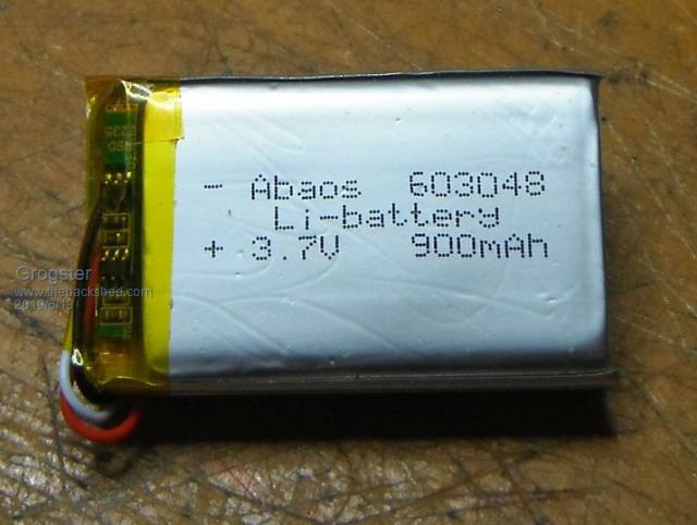

Last point your battery pictured looks like it already has built-in under-voltage protection. Doesn't matter but another point of failure.

Battery having in-built under-V protection: That could be a valid point, I will investigate that side of things. Edited by Grogster 2019-06-14

  Grogster said  The boost-converter is designed to be connected to a 3.7v battery, and to provide 5v output, and is based on an MT3608 boost-converter IC. This is ideal for feeding into many MM circuits, as they also have on-board 5v-to-3v3 regulators themselves.
Hi Grogster,
the MT3608-datasheet says the Quiescent Current is
Quiescent Current (PFM) VFB=0.7V, No switch 100-200μA
Quiescent Current (PWM) VFB=0.5V, switch 1.6-2.2mA
what is your measurement?
Maybe interesting: the MT3608-PIN 4 is the "Regulator On/Off Control Input." or EN(able).
BTW. I had the same idea a few months ago.
Kind regards
Michael

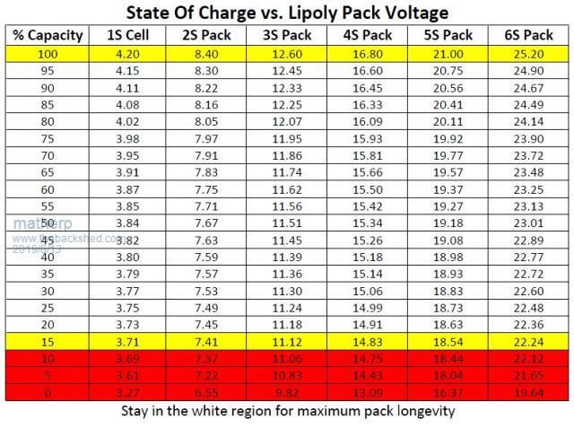

I'm confused about the low-voltage dropout point. Matherp's chart indicates that it should occur at no lower than 2.73V with 20% remaining. But is that a "no-load" voltage? I've read elsewhere that under load, 2.5V is a good cutoff (but it depends on the current being drawn). (And I've also read that no lower than 40% is best for the life of the battery through many charge/discharge cycles.)
Does the chart apply to both 18650s and the form factor that Grogster is using? And there's the question of different Lipo chemistries, which result in different ideal low-voltage dropout points.
How about with something like the 18650 charger/ups that I linked to, powering the micromite/pi from the 3.3V output (which I think doesn't drop out), and monitoring the 5V output for the dropout, which would allow the device either to power itself off or send a "low-voltage" warning. That still wouldn't fix the problem of the battery module having to be power-cycled to turn the 5V back on after a low-power shutdown.

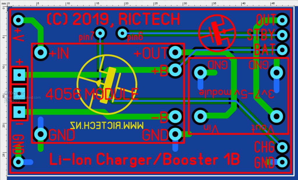

Latest version image:
Simple five-wire interface to your MM project:
OUT - Main output. Connect this to your MM project Vin.
STBY - 4056 charger IC standby LED output(pin7).
BAT - Positive of LiIon battery.
CHG - 4056 charger IC charger LED output(pin8).
GND - Ground.
STBY and CHG must be connected to 5v tolerant MM pins, as they are active-low, being pulled high to V+ and going low when they are active. I recommend still using 1k series resistors on these two signal lines.
BAT is the positive of the LiIon battery pack. You can measure the battery voltage with an ADC pin on the MM. You should use a 5v pin for this also.
