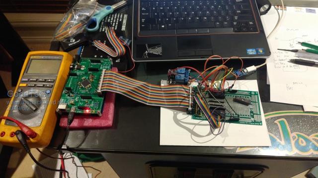

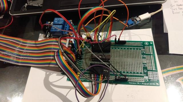

After mulling it over for a while (and thanks Quazee for the tips!) I decided to have a go using my E100, Grog's expansion/prototyping board, a 5v-to-whatever boost converter for the supervoltage and a dual relay module for supervoltage switching.
Cobbled together, I ended up with this mess....
and a close-up....
The E100 had plenty of 5v tolerant pins for this application, and direct wiring it made the software side of things a lot easier. One thing though, because I am using pins 66 and 67 on the E100, I had to remove the plug-in RTC module from it, because it was pulling both pins up to 5v. (Made two of the data lines all screwy and took me longer than I care to admit to figure it out)
Even though the EPROMs I'm using (Cy7C291 and Cy7C291A) are 2kx8, For the application I needed them for, I only required 256x4. (82S129 replacement). So I dispensed with the A8-A10 address lines. (grounded them)
Lots of chip swapping for reading/writing/erasing/blank checking meant that invariably I was gonna stuff up.
And I did.
Reading the datasheet, you must have 5v Vcc applied before applying the 12.5v or 13.5v (depending on the IC) supervoltage. I killed two chips stonedead because I forgot to reconnect Vcc during development. They both got stinking hot and also caused the E100 to reset!
So I connected the EPROM Vcc pin back to pin 80 on the E100 as a monitor. My quick and dirty test program now checks for Vcc before it does anything. That solved that little issue. (and also eliminated the non '-A' variant of the chip from my stock. )
So now I can reliably program and read these nice little EPROMS from the early 90's.
The next step is to work out how to get the program to load a file and use the contents to burn the chip. Oh, and chicken-scratching out a schematic, or even get a proper pcb made up.
These Cypress UV EPROMs differ to normal UV EPROM's when it comes to blankchecking. Normal UV EPROM's erase to all "FF"'s. These don't. You have to configure the chip a certain way and check for zero's instead.
If anyone is interested in the 'proof of concept' code, I'm happy to post it.
Cheers!
GTG!
