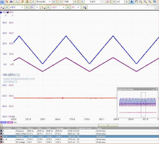

The picture shows the generated triangle wave and the voltage that would be across the component by subtracting the two channels where the second channel is connected to the virtual ground. Note: both scope channels are needed as the virtual ground is different from the scope ground and bad things happen if you try and connect them
Edited by matherp 2019-06-14

Dear matherp,
If you check out Paul_L s post, or google octopus cicuit, that explains a lot. But to be honest, you are nearly there.
The octopus circuit creates a floating sine wave from a transformer secondary winding. On side is fed to the component under test, this is signal A. The other side of the compinent is grounded. The other side of the winding, signal B, is connected to ground through a 47k resistor.
A and B connect to a scope in XY mode. A represents voltage across the component. B the current ( voltage acros series resitor 47k).
If i understand right your AD822 output is connected to a resistor, and then to the component under test.
Other side of the component under test is at split rail.
So signal A is simply the voltage at the component under test (a/d channel 1)
Signal B is the differece between the AD822 output(a/d channel 2), and signal A.
Simply subtract values to get B.
You need to take into account that using a 47k resistor to determine a component characteristics, the measurement ciruit must be signifcantly higher impedance. This applies to signal A. The AD822 output is low impedance. I suggest a high impedance divider and then buffer in an opamp before going into the a/d.
Something in the lines of 10 meg/1.2 meg that is roughly divide by 9, suiting the 3.3v range on the a/d.
