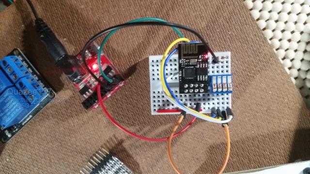

The ESP-07 and 12's are easy to get the 4 relays working. While
waiting for my burner for them (very slow boat from CHINA).
I went back to play with the ESP-01's. I found out that you can
turn off serial port freeing up Tx = GPIO 1, Rx = GPIO 3 now I

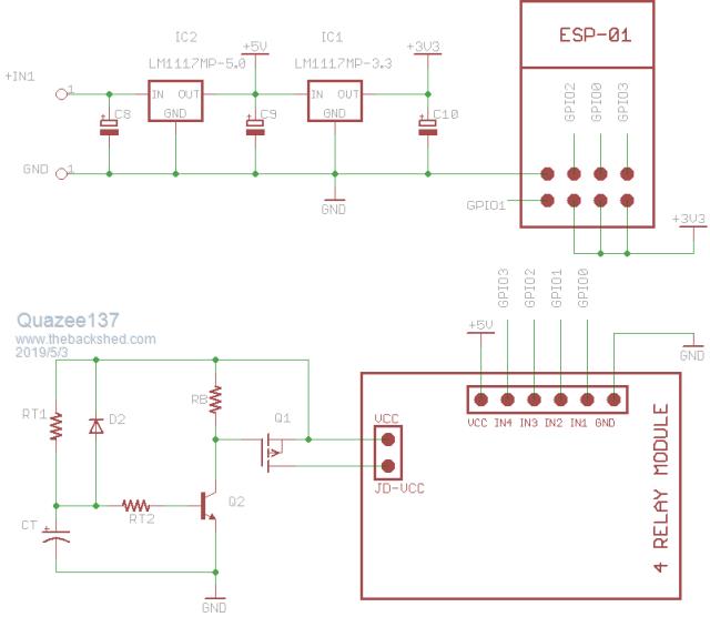

can use them to drive the relays. Well except the startup chatter
will fire off GPIO1. Not good !!! But wait what if the relays had
a slow start function. Then the ESP-01 can power up and not affect
them. So here is the basic concept.

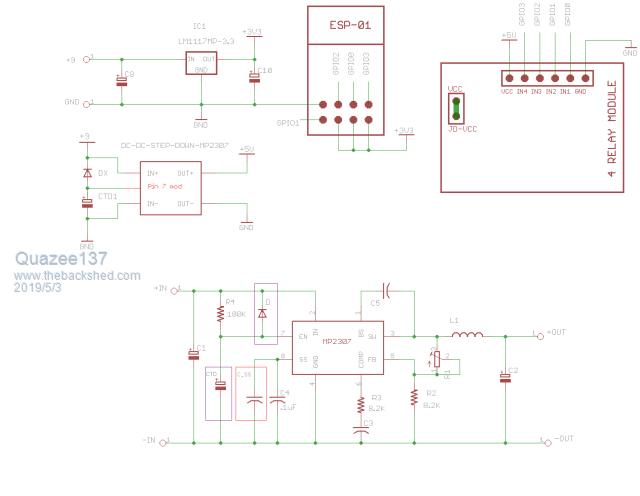

I liked the circuit from Grogster post Grogsters post
I remembered seeing this post Grogsters post while looking for the other one.
Had 10 of them I got to top off and order (free shipping LOL). Looking at the

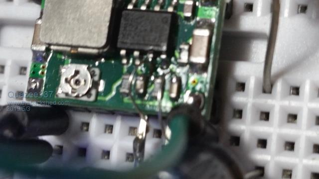

MP2307 data sheet I saw that there is two pins of intrest 7 (EN) and 8 (SS).
Getting these out to play with was 20 min's of hit and misses but got them.
First played with pin 8 but even with a big cap not as much time for the
ESP-01 to get settled. So on to pin 7 and the works with adding Diode and
220uF cap now a few sec's delay while the ESP-01 powers up.
and the sender is so simple

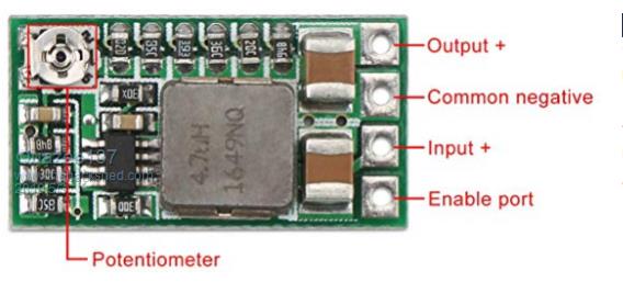

To make this easier there are these modules
5 on order to play with.

4 I/Os on an ESP-01. Cool. How do you turn off Tx & Rx?
Also, do you have a link for the module shown in the last image?

Quazee137
On the sending ESP Easy unit I didnt add resistors in line with RX and TX
while testing but may be needed if you have pins to make use of serial port.
Here's a few
Droking
amazon
alibaba

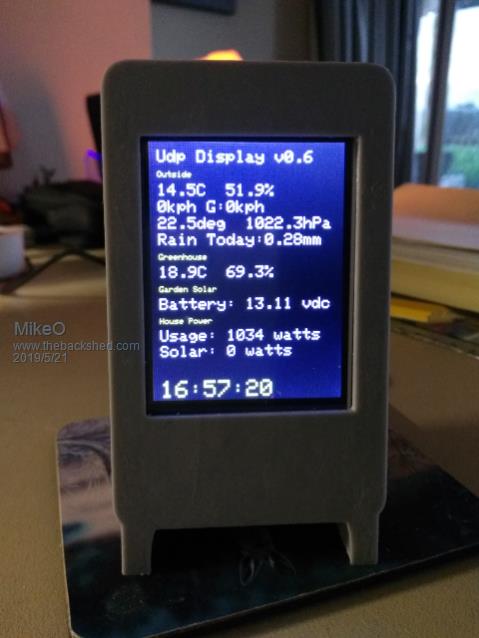

I also have been playing around with Annex. Seems to work very well. I recently updated all my remote sensors that had ESP8266 with ESPeasy firmware and for most cases was all I needed to read most sensors. the ESPeasy also works great wifi is no longer a problem with loosing comms as the ESPeasy manages to reconnect with no problems. I just have one esp8266/micromite (mx170) combination where the mx170 decodes the data stream from a wind sensor and the ESPpeasy sends the data via UDP with the data coded in json.
I have a Node-mcu module running Annex as a tiny data monitor. the Annex software decodes the UDP data and displays it on a 2.8" SPI LCD display. This is a very simple setup and I was surprised how simple it was to code and so far it seems bullet proof.
'Udp Display
ver$="v0.6"
tft.init 16, 4, 4
TFT.FILL TFT.RGB(0,0,0)
TFT.TEXT.size 2
tft.text.col &hffffff, &h00
TFT.TEXT.POS 10,10
tft.print "Udp Display "+ver$
TFT.TEXT.size 1
tft.text.col tft.rgb(255, 255, 0), &h00
TFT.TEXT.POS 10,35
tft.print "Outside"
TFT.TEXT.POS 10,135
tft.print "Greenhouse"
TFT.TEXT.POS 10,175
tft.print "Garden Solar"
TFT.TEXT.POS 10,215
tft.print "House Power"
TFT.TEXT.size 2
'end basic display
ot$= "not found"
oh$= "not found"
ora$= "not found"
op$= "not found"
gt$= "not found"
gh$= "not found"
bv$= "not found"
pw$= "not found"
sw$= "not found"
wd$= "not found"
ws$= "not found"
wg$= "not found"
Touch.Setup 15
OnTouch touchme
udp.begin 5001
onudp goudp
'screen update loop
do
update=1
if ot$ <> "not found" then
TFT.TEXT.POS 10,50
tft.print str$(val(ot$))+"C"+" "+str$(val(oh$))+"% ";
TFT.TEXT.POS 10,70
tft.print str$(val(ws$))+"kph G:"+str$(val(wg$))+"kph ";
TFT.TEXT.POS 10,90
tft.print str$(val(wd$))+"deg "+str$(val(op$))+"hPa ";
TFT.TEXT.POS 10,110
tft.print "Rain Today:"+str$(val(ora$))+"mm ";
end if
if gt$ <> "not found" then
TFT.TEXT.POS 10,150
tft.print str$(val(gt$))+"C"+" "+str$(val(gh$))+"% ";
end if
if bv$ <> "not found" then
TFT.TEXT.POS 10,190
tft.print "Battery: "+bv$+" vdc ";
end if
if pw$ <> "not found" then
TFT.TEXT.POS 10,230
tft.print "Usage: "+pw$+" watts ";
end if
if sw$ <> "not found" then
TFT.TEXT.POS 10,250
tft.print "Solar: "+sw$+" watts ";
end if
TFT.TEXT.size 3
TFT.TEXT.POS 10,295
tft.print time$;
TFT.TEXT.size 2
pause 5000
update=0
loop
wait
goudp:
v$ = udp.read$
print v$
ret$=json$(v$,"otemp")
if ret$<>"not found" then
ot$=ret$
end if
ret$= json$(v$,"hum")
oh$=ret$
end if
ret$= json$(v$,"rain")
ora$=ret$
end if
ret$= json$(v$,"gtemp")
gt$=ret$
end if
ret$= json$(v$,"ghum")
gh$=ret$
end if
ret$= json$(v$,"bv")
bv$=ret$
end if
ret$= json$(v$,"powerW")
if ret$="0" then
pw$="Solar"
else
pw$=ret$
end if
end if
ret$= json$(v$,"solar")
sw$=ret$
end if
ret$= json$(v$,"pres")
op$=ret$
end if
ret$=json$(v$,"dir")
wd$=ret$
end if
ret$=json$(v$,"speed")
ws$=ret$
end if
ret$=json$(v$,"gust")
wg$=ret$
end if
return
touchme:
wlog "touched x/y "+str$(touch.x)+" "+str$(touch.y)
wlog ramfree
return
