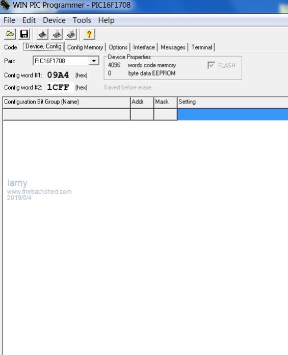

Before I give up on the 16F1708, I have decided to see if anyone can help me with WINPIC. The situation is as follows:-
I gave up trying to programme a 16F1708 with PICKIT3 as it (i.e. PK3) appears to be faulty (I tried several suggestions from people on various forums but nothing worked.
Several said that the PK3 "is a pain".
I have always used WINPIC to programme PICs, but the 16F1708 is not included.
I tried to enter the 16F1708 into WINPIC according to the WINPIC help document "Help - my PIC is not supported".
I managed to do part of it, but eventually came to an impasse. I could not work out what to do next. The instructions are not clear.
Does anyone know how to do it?

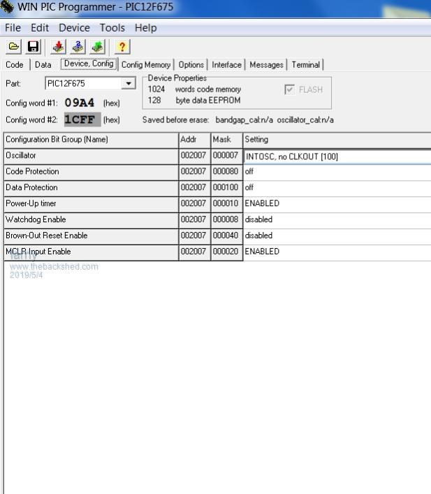

I have attached a screen grab of the WINPIC screen which shows how far I got.
The second screen grab shows the same screen for a 12F675.
Any assistance will be appreciated.
