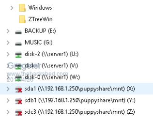

W10 networking this time. I have removed one of my server machines from the network, but W10 insists on holding onto the shares and won't let them go.
"puppyshare" is no longer on the network while I make some changes, but W10 won't let go of the references. If I try to right-click/disconnect them, File Explorer locks up completely and I have to kill it with Task Manager.
The Puppy Linux box has been off the network since last weekend, so I WAS just waiting for W10 to decide that those shares weren't coming back, and to remove them from the tree itself - but this isn't happening, and I can't now seem to get rid of them.
Anyone seen this kind of behaviour, and if you have, what did YOU do to fix it?

from a command prompt, try
NET USE X: /DELETE
for the full options available
NET USE /?

I can report that this did seem to do the trick.
I ran CMD.EXE with administrator and after running this command on each of the shares, exit CMD, back in File Explorer, they are now gone. Thanks.

Just use file explorer,
Click on “This PC” (or my computer or what ever your version says to show all drives)
Right click on the network drive in question and select DISCONNECT.
Done!

Ahhhhhhh........no, not in this case.
If you have a read of my first post, you will discover that when I try to do that, File Explorer was totally locking up and I had to kill it with Task Manager.
Otherwise, I most certainly would have done it that way.

Yeah, well, I have used EXACTLY the method that Mick mentions in all but this case.
Right-click the share, click DISCONNECT - simple.
But as soon as I right-clicked the share, that was when I just got nothing but the circle going around and around, then File Explorer would say it had stopped responding. I did leave it like that for a while to see if it recovered, but after five minutes it was still locked, so I then killed File Explorer with Task Manager.
Every time I tried that, I got the same lock-up problem, and that has never happened before. As I say, YES - normally I do exactly what Mick was suggesting, but for whatever reason, Windoze would not let me this time.
Oh well. Jim's suggestion of the command-prompt method DID work, so at least that is a work-around I can use if that is ever an issue for me again.

Example: mapped network drive - network resource removed - mapped drive still showing in explorer with red X - "disconnect" results in "error - network resource no longer available" - mapped drive still there. (Grogs got the hourglass instead of the message it seems).
Reboot fixed it. (the NET USE X: /DELETE wouldn't work either - "can't find drive to delete" or similar message). Windows obviously remembered the drive removal attempt but needed the reboot to clear the caching.
