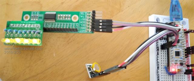

Posts: 3881
Posted: 02:33pm 24 Mar 2019
While we're at it with I2C, here is an MCP23017 16-pin I/O expander:

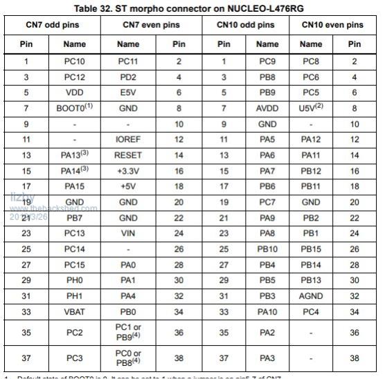

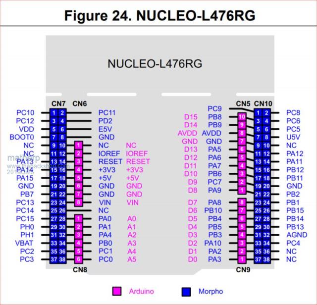

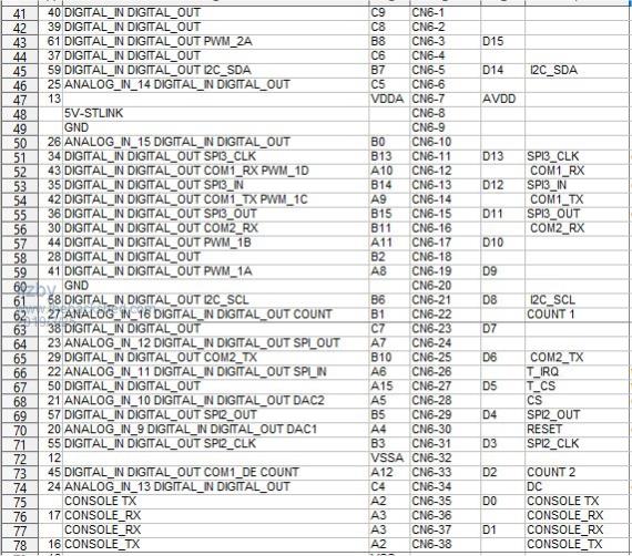

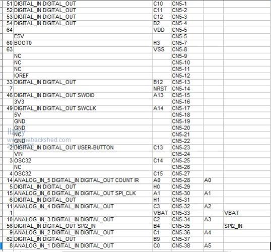

Posts: 3881
Posted: 12:23am 25 Mar 2019
Not specifically RTC related, but I2C, so I'll post here.
I'm about half-blinded staring at the Nucleo-L746 board, the Armmite L4 manual, and the STM Nucleo-64 pdf: Nucleo-64
But I can't get I2C to work. I'm connecting the DS3231 RTC (yes, I know there's an onboard RTC which works if I provide VBAT, but I haven't gotten that far yet). The DS3231 had the date programmed by a picaxe, and it shows the date properly when read by the picaxe (or by the Nucleo L432). On the L746RG board I'm connecting I2C-SDA to D14 and I2C-SLA to D8 (pins 59 and 58--B7 & B6).
I2C OPEN works, but I2C write 104,0,1,0 give an error in mm.i2c. I've run twofingers' scanner, and it doesn't find the RTC:

Here is my understanding of the pinout by connector (CN5 & CN6).
If someone can tell me that I2C works for them with the Nucleo-L476, and what the connections are, I'll stare at it some more.

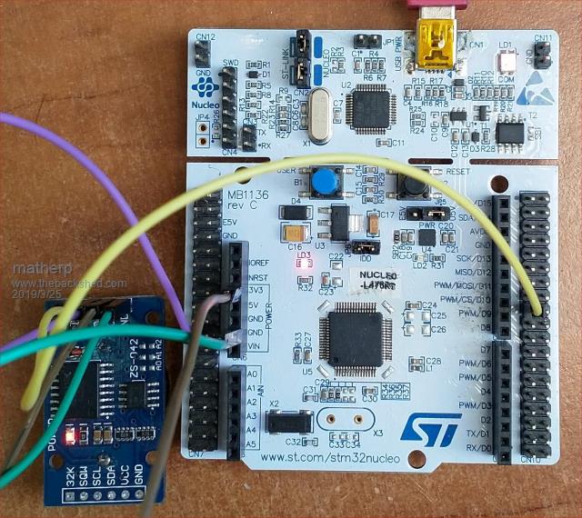

Posts: 6607
Posted: 02:48am 25 Mar 2019
  lizby said  On the L746RG board I'm connecting I2C-SDA to D14 and I2C-SLA to D8 (pins 59 and 58--B7 & B6).
I don't have the L476 (I assume that's the one you have and L746 was a typo)
On my L433 Nucleo-64 I connected the RTC as per Peter's manual, which I think is the same as you.
> RUN
I2C-Scanner from Adr. 8-119
8> 1 9> 1 10> 1 11> 1 12> 1 13> 1 14> 1 15> 1
Found I2C-Address at 104 (&H68)
105> 1 106> 1 107> 1 108> 1 109> 1 110> 1 111> 1
Try testing your pins with SETPIN DOUT to make sure that they do work.
Apart from that, I don't have any suggestions.

  Quote  I'm about half-blinded staring at the Nucleo-L746 board, the Armmite L4 manual, and the STM Nucleo-64 pdf: Nucleo-64
Best way to get the pins is to correlate the port number in the pinout listing in the manual with the Nucleo datasheet.
The manual gives:
58 DIGITAL_IN DIGITAL_OUT I2C_SCL B6
59 DIGITAL_IN DIGITAL_OUT I2C_SDA B7
looking at the Nucleo datasheet
gives CN10-17 or Arduin-D10 for B6 and CN7-21 for B7. This appears to works properly talking to a DS3231.
Posts: 3881
Posted: 02:09pm 25 Mar 2019
Thank you very much for that, and for the L476RG pinout image--I had somehow managed to get the wrong one, so no amount of staring would have helped me.
And that works--thank you again. Now back to the drawing board for the rest of the connections.
(I had gotten my pin-number to pin-name connection from the STM32 Nucleo-64-P boards pdf, which doesn't include the L476RG pinouts (which are different). The correct chart is in this PDF: Nucleo-64 )
