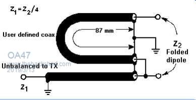

Would like a more knowledgeable 'shedder to help me understand using a 4:1 coax balun to match RG174 coax to a 433Mhz folded dipole. From what I understand the coax balun should be half lambda so that each end attached to the dipole is a maximum level. The balun should give 4:1 impedance ratio that is folded dipole starts at 300 ohm impedance and divided by 4 gives 75 ohm resultant. I would like to connect the antenna using SMA connector and I am thinking that the impedance of RG174 to SMA cables I have are 50 ohm. Can I use the co-ax balun as they look very simple to achieve the connection or am I barking up the wrong tree again.

The difference between 75 and 50 ohm will make little difference in a receive situation. The 87mm on the picture is a bit off. I calculate 277mm for a coax with foam dielectric or 229mm for a solid dielectric.

Thanks lew247 and crez. I am looking to use these antenna on low power 433Mhz radio telemetry units that are most likely transmitting 100mW or so. Most of the units are working fine with a stick antenna on an aluminium ground plane but a couple are scratching for a little bit more signal and I thought a 3-4 element yagi might be the answer.
@crez the diagram I used was for a 1200Mhz system that's why it was 87mm.

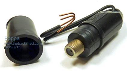

Just wondering because most commercial yagis already have the balun inbuilt and are available from under $20. Although the balun may not be intended for tx use, at 100mW many receive only ones could be used too as long as they use a transformer style balun

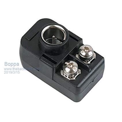

(A hint for cheap low power tx baluns- the old style 75 ohm to 300 ohm tv baluns can be used up to 5w and (depending on manufacturer) will usually work down to about 5mz and up to about 700mHz)- I have used these myself on UHF cb yagis (4w) and they work well despite being 75 ohm and the cb 50 ohm
I used one of these with the screw terminals attache to holes drilled in the aluminium element on my home made uhf cb antenna (modified uhf tv antenna), put a belling lee on the end of the rg58 coax and then put the whole lot in a jiffy box with a couple of slots filed out of the lid for the folded dipole to come out (as those balums weren't waterproof obviously)
These days I'd just use of of these instead (cut the excess 300 ohm wires off as much as possible)

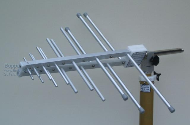

Another 'tv antenna' that is useful for transmitting through is a 'log periodic' antenna, they are broadband on both rx and tx, and although dont have as much gain as a yagi with the same number of elements, their extremely broad frequency response means they can be used without fear of too high a swer once you move off the design frequency (unlike a yagi)- in fact for a long time I used the one antenna (through a switch of course ) for a scanner, 2m, 70cm and uhf cb... they can be told by their 'twin boom' design
