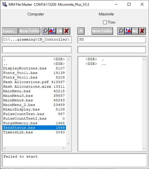

However, now when I reboot the system and open the MMfile option, I get "Working...", then <DIR> . <DIR .. in the right hand window, which looks very promising.
Now when I select a file in the left window and click on the red-arrow icon, I get a MM File Master pop-up with the file name in it. I click OK and get "XMODEM RECEIVE filename" in the bottom section, followed by "Working..." in the right hand window, then back to the <DIR> . <DIR> .. and the message "Failed to start" in the bottom section (see below).
Clearly the system is seeing an SD card, the pins are presumably right, but for some reason, I can't get any further.

What is it that you want to do?
If you got the the ">" prompt and type "files", do you see what you expect?
You can send files from the PC to the micromite in teraterm with F10 (for xmodem receive), send in teraterm, and 'save "filename"' back at the ">" prompt, and reverse the process with 'load "filename"' and XMODEM SEND.

You know the story about the wheel-tapper that rejected 300 railway wheels - and then found that his hammer was cracked?
Bad SD card! Problem solved. Thanks.
