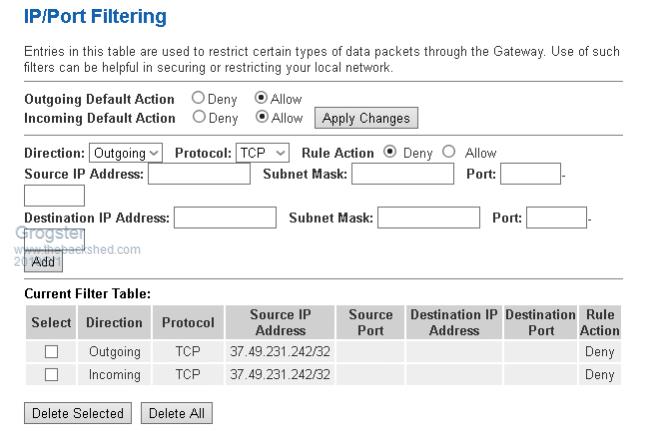

If you want to block locally, go into your router's firewall, and then into IP filtering/blocking, and add a couple of rules to block both inward and outgoing traffic to that IP address:
"Rule Action" set to Deny, means the router will just bounce any attempts at incoming from that IP, or for your machine to try to send any response to that IP address.
Agree about the personal IP address. I recommend you take this image down, and replace with plain text, or at least blurr your IP address as this makes you identifiable on the global internet to anyone. The destination address is you on the internet - YOUR IP address. Well, your router's IP address anyway, but it never a good idea to post your own IP address if you can avoid it.

I'm far from experienced at this, but I think "deny" is deprecated because it lets the attacker know that a router is there, providing reason for further exploitation attempts.
