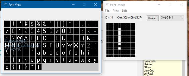

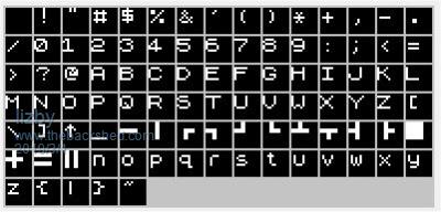

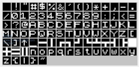

Jim--resizing didn't do exactly what I was hoping it would by some magic--essentially scale the bitmap. I resized my 8x8 font where the single-line PC graphics characters are in the first lower case bank (0x60-0x6f) to 12x12. The result was that 4 blank columns were added to the right and 4 blank rows were added at the bottom.
Is there a way to do what I want to do? I understand the problem is non-trivial.

Before:
After:

Posted: 08:38pm 28 Feb 2019
Resize is only intended to make a non standard font such as 9x13 fit into a size that is accepted by MMBasic.
You do have the ability to double the size of fonts but not fractional scaling. I considered fractional scaling of small bitmaps too troublesome.
A better way would be to start with one of the larger fonts such as 9x14 and resize it to 10 x 12.
The number of characters across the font view will depend on the total number of characters. Font sizes vary from one character to 255 so fixing the width to 16 is not ideal. I went with width equals 1.5 times the height.
