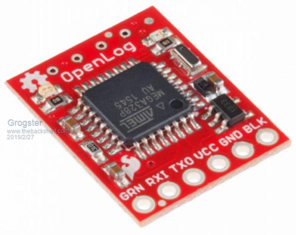

Hi all.
This is a somewhat odd request - what are the dimensions of the OpenLog module?
I cannot find that on the SparkFun website, or on their GitHub documentaion.
There is everything BUT that.
If any member here has one of these, can you please measure it for me.
I am going to assume that the UART edge of things is about 15.2mm...

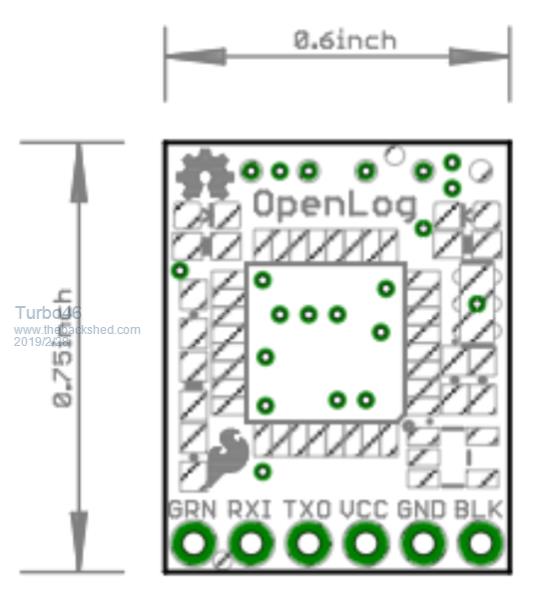

I found this this

15.24 mm by 19.05
