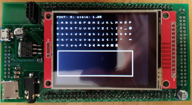

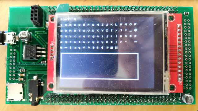

Following up on matherp's micro-font thread which I pretty much hijacked, here is an 8x8 font with the single-line "box drawing" graphics characters based on those of the old IBM PC Code Page 437 encoding.
Below is the program which drew that screen, including the font definition. I placed the characters not where they are on Code Page 437, but right above the normal ascii characters, positions 128-139 (&h80-&h8B).
As I said in the other thread, it may seem silly to want these characters on a device which has the true graphics ability of the micromite, but I had a use for them, it familiarized me to a degree with how fonts are defined in MMBasic, and I had fun. What more can you ask?

Corrected because I had horizontal uptic and downtic wrong. Also added "+". Code has been corrected in first post, but CG was too quick for me to get the photo corrected.
(Note that "Scale" in the photo is not effective--only values 1-15 are allowed.)

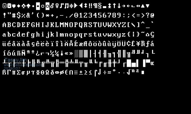

4 more line drawing fonts
These are all the upper 127 characters of the IBM fonts.
Sizes are 8x8, 8x14, 8x16, 9x16

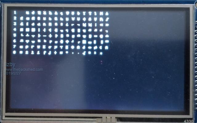

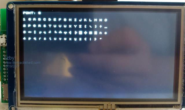

I ran into various problems with the PC drawing characters at positions above 0x7f--immediately above there some were "magic" characters, so that when I downloaded them, "AUTOSAVE" and "RUN" were invoked. I moved them up 32 positions and still had trouble reading them into an mmbasic program from a file, or inserting strings of them as CONST statements.
My solution was to move them down to the lower case ascii slots, specifically 0x60-0x6e. This eliminates those lower case characters, but they are available by using another 8x8 font. I also added the block character--all bits are 1.
Sorry for the blurryness of the photo. The display itself, a 4.3" SSD1963 on a Nucleo H7 backpack, is quite crisp.

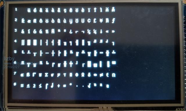

Posted: 04:49pm 26 Feb 2019
Thanks for those fonts, Jim. For display purposes, I replaced the first character with a space (all zeros). Here's the 8x8 font.
The program:

The 9x16:
[code]
dim string A
dim integer i,j,k,ifont,iStep,nLines,vLoc
cls
ifont=8
font 8
print "font ";ifont;": ";mm.fontheight;" ";mm.fontwidth
for k = 1 to 8
A=str$(k,2,0)+" "
print A
text 0,vLoc,A,L,7,,rgb(white)
A=""
for i = 1 to 16 : A = A + chr$((k-1)*16 + i) + chr$(1) : next i
text mm.fontwidth*3,vLoc,A,L,ifont,,rgb(white)
vLoc=vLoc+mm.fontheight*2
next k
' IBM_VGA9_U.bas
' Font type : Full (127 characters)
' Font size : 9x16 pixels
' Memory usage : 2290 bytes
' Font adapted from: http://www.rinkydinkelectronics.com/r_fonts.php
' 7F011009 0C0F0000 010326CC 0F33C280 E0638001 00000000 06000033 CC983163
DefineFont #8
7F011009 00000000 00000000 00000000 00000000 00000000 06000033 CC983163
C00E3366 00000000 06060600 19E30300 3160C0FC 0000808F 08000000 03800D0E

I thought I would try a font with 254 characters. I wasn't sure if ewe could go above chr$(127). We can.
dim integer x,y,k
cls
font 8
for k = 1 to 255
x = ((k-1) mod 32) * 20 + 20
y = int((k-1) / 32) * 40 + 10
text x,y,chr$(k),c,8,2
next k
save image "Fonts.bmp"
' IBM_VGA9x16_all.bas
' Font type : Full (254 characters)
' Memory usage : 4576 bytes
' First character : 1
DefineFont #8
FE011009 901F0000 050A542A A040997A 0000C04F 00000000 B7ED9F1F E786FDFB

The results:
  Quote  I ran into various problems with the PC drawing characters at positions above 0x7f--immediately above there some were "magic" characters, so that when I downloaded them, "AUTOSAVE" and "RUN" were invoked.
There will be problems with chr$(3) and chr$(26) if you embed them directly into a string and try to use AUTOSAVE. Others might also be trouble. Theer shouldn't be an issue if you upload using XMODEM
There is no problem printing them.
The above test was on an Armite H7 with 5inch display.
Posted: 11:57pm 26 Feb 2019
No problem printing characters above 0x7f, but I had varying problems downloading them with AUTOSAVE or after downloading them in strings with XMODEM, printing them.
Posted: 01:38am 27 Feb 2019
you'll find that AUTOSAVE clears the top bit on all incoming characters, while the micromite's built-in editor just fails to cope with the top bit being set.
see this thread for discussion:
https://www.thebackshed.com/forum/forum_posts.asp?TID=11139
rob :-)
Posted: 04:41am 27 Feb 2019
Characters above 0x7f will also get caught up with the ASCII/UTF8/Unicode translation problems.
