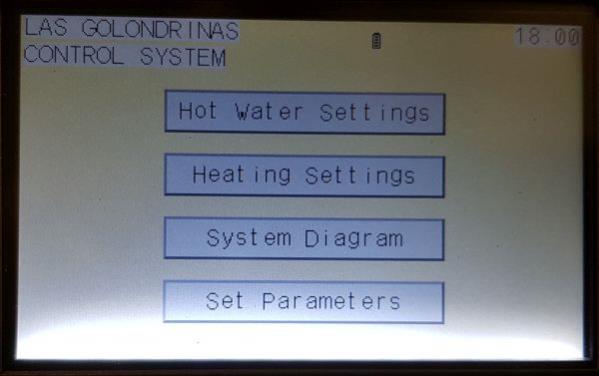

I'd appreciate some advice on a problem I'm having with a heating controller project. This uses a number of 'pages' to display different things. Moving between pages is mainly trouble-free, except for one page.
This is the 'main menu' page:

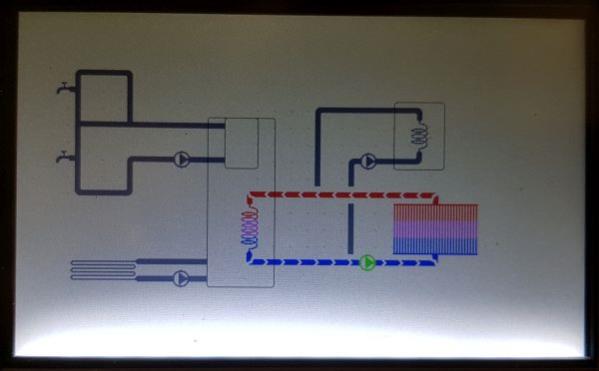

The third option on here shows an animated system diagram:

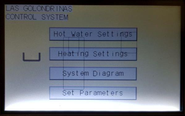

This works fine. The problem is when I return to the main menu page:
I have tried all sorts of ways of clearing the screen, starting with the original CLS, then two CLS statements with a pause in between, overwriting the page with a filled box, but I still get the problem!
The relevant code sections are as follows:

'This gives rise to illustration 3 - and I just can't get rid
'of the stray bits of diagram!

I think its probably related to issuing graphics commands within an interrupt. The CLS and PAGE 1,9 stuff may not be started/completed when you expect.
P5_Click and P1_Click are interrupts and general practice is to only do quick things in them, say set a flag that is then acted upon in the main DO:LOOP.
I would also try to only ever set GUI INTERRUPT only once at the top of the program and have only one subroutine.

OK - that seems to have solved the original problem, but...!
It has introduced others. Rather than deluge you with detail, let me just ask a question: if you have several pages of controls displayed at one time and you output something to the screen, which page does it affect? The first one listed? The last? All of them?
What is now happening is that the initial menu display is fine. I then go into the animated mimic display page and that is fine too - and it includes the battery and time elements that were on the menu page (see the pictures above). However, when I return to the menu page, these have disappeared. And when I go to the other pages, they don't appear either.
It's as though running the animated display has overwritten the time and date areas and these are now lost for good.
Any ideas?

Your DoDisp sub is PROBABLY where the problem is, in combination with your use of CLS to clear the screen. In a GUI, you don't really use CLS to clear the screen, you DISABLE the GUI controls you DON'T want to see at any given point, or use GUI pages as you have started to do. You can't really mix GUI controls and standard drawing controls. From the advanced manual, page 38:
[Quote=Advanced Manual]
There are two types of objects that can be on the screen. These are the GUI controls and the basic drawing objects (PIXEL, LINE, TEXT, etc). Mixing the two on the screen is not a good idea because MMBasic does not track the position of the basic drawing objects and they can clash with the GUI controls. As a result, unless you are prepared to do some extra programming, you should use either the GUI controls or the basic drawing objects – but you should not use both. So, for example, do not use TEXT but use GUI CAPTION instead. If you only use GUI controls MMBasic will manage the screen for you including erasing and redrawing it as required, for example when a virtual keyboard is displayed. Note that the CLS command (used to clear the screen) will automatically set any GUI controls on the screen to hidden (ie, it does a GUI HIDE ALL before clearing the screen). The main problem with mixing basic graphics and GUI controls occurs with the Text Box and Number Box controls which display a virtual keyboard. This can erase any basic graphics and MMBasic will not know to restore them when the keyboard is removed.[/Quote]
I encourage you to read and re-read the 'Advanced Graphics Programming Techniques' section of the Micromite Advanced manual starting at page 35, until you understand all the important points made in that section. They really are important, so as to save you mental stress with GUI programming.
Put simply, if you use ANY of the GUI controls, then EVERYTHING you see on the screen should be a GUI control, and not a mix of GUI controls and standard drawing commands.Edited by Grogster 2019-02-25
disco4now
Joined: 18/12/2014
Posts: 1162
Posted: 02:30am 24 Feb 2019
This from the MM+ manual page 40 might provide an answer.
When you use a CLS to erase the schematic it is also hiding the controls on all the currently selected pages. This hide of the controls on page 9 would still be in effect when page 9 is re-selected as part of the main screen. The command
GUI SHOW ALL
could be used after the CLS to undo the unintended HIDE of the controls.
You could also draw a full size BOX the background colour instead of using CLS.
