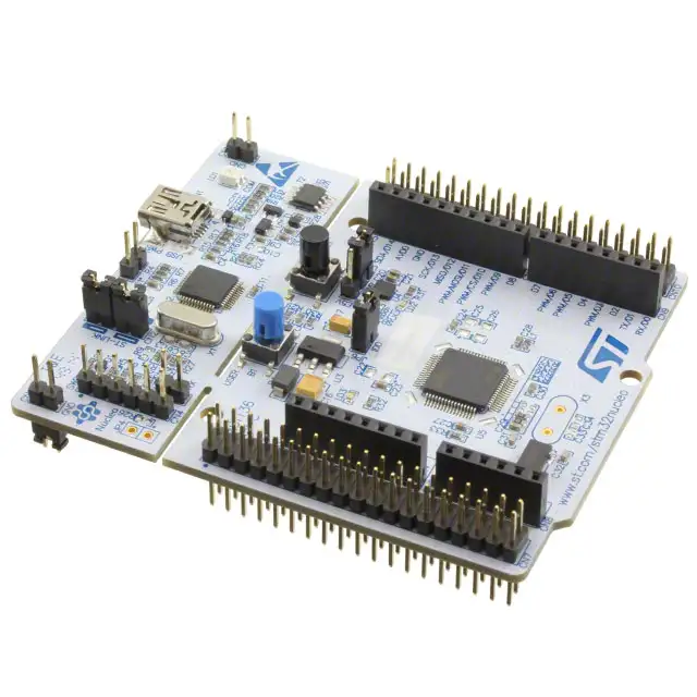

1) Make sure you have a NUCLEO STM32L476 board
https://www.st.com/en/evaluation-tools/nucleo-l476rg.html
https://www.digikey.com/product-detail/en/stmicroelectronics/NUCLEO-L476RG/497-15881-ND/5347711

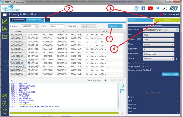

5) flashing the Basic interpreter
Open the STM32Cubeprogrammer
(1) click the 'connect' button top right to connect to the board
(2) click the 'open file' tab and select the image file ( i used the .HEX file provided in the distribution )
(3) click the Download button and wait for programming to complete.
(4) click the disconnect button top right ( same as the connect button )

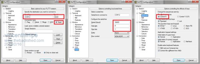

Fire up Putty ( or your preferred terminal program. )
Connect using the COM port you found, 34800 as baudrate , no parity , 8 databits , 1 stop bit : 34800,n,8,1
It is important to set up the backspace character correctly to CTRL-H for the command line to be editable.
in the above image i have set my com port (COM12) , serial connection , 38400,8,1 and the Control-H character for backspace. You can save this to Putty Defaults, or a custom setup file so you don't have to do this every time

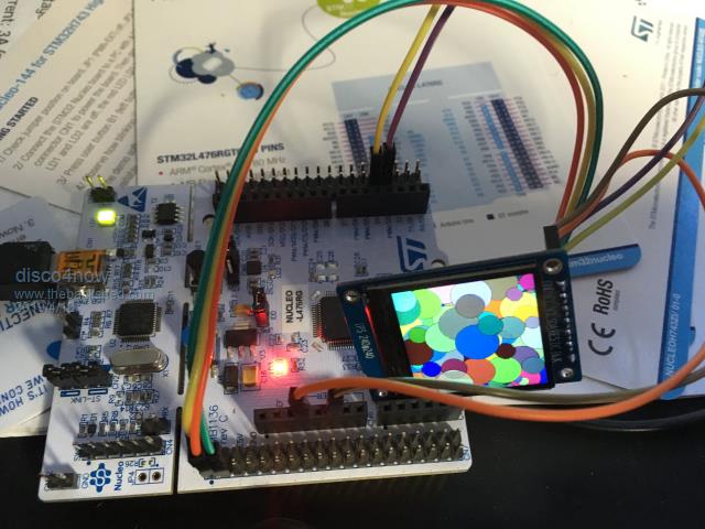

Hi all
I receive my Nucleo L476RG (l4 64 pins)
I have also an LCD 1.3" 240x240 St7789 (lcd alone, not hat)
Nucleo work correctly (benchmark ok, calc Pi ok)
but in graphic mode, I have nothing on screen, always black (prog "Gauge")
config:
SPI2 CLK (p55 CN10-31)
SPI2 MOSI (p57 CN10-29
SPI2 MISO (p56 CN10-27) (not use)
GND CN7-19
+3.3v CN7-16
DC P51 (CN7-1)
CS P52 (CN7-2)
RST p53 (CN7-3)
BLK not use
CPU 80
OPTION LCDPANEL ST7789, LANDSCAPE, 51, 53, 52
ARMmite L4 MMBasic Version 5.05.09
prog test: Gauge
lcd work correctly on arduino uno (graphic test)
I have change speed (CPU 48), nothing!
I have also tested without CS signal (this signal is not wired on "chinese" LCD, I have add this, and after, it is good on UNO
I have tested with ver 5.05.07. Its same pb
help.. help ...helpEdited by goc30 2019-04-19

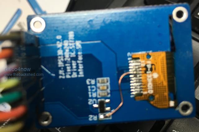

Hi,
I have one of these ST7789 clones that comes without the CS pin exposed. I have the source for Peter's driver for the MM2 and MM+ but have not been able to get it to go as is , i.e. with CS permanently selected on the board. Apparently when they work with Arduino, they use SPI mode 3 but I have no success. In the end I modified it to expose the CS pin in lieu of the BLK pin.
After the modification it works on the Nucleo L476RG (l4 64 pins) with MMBasic set up as you have it.i.e.
Here is my modification:
1. Remove R2
2. Pin 8 of the ribbon is CS, it is connected to GND on the PCB but under the ribbon.
I used a heat gun and lifted the ribbon, then cut the track at the base of pin 8 on the PCB, checking it was no longer connected to ground.
3. Put the ribbon back
4. Run a small wire from pin 8 to the R2 pad that goes to the BLK pin.
5. BLK is now gone and is now CS.
The bit you may not have done is remove the permanent GND on CS, this seems to stop it working, the GND being applied by CS is what triggers the initialisation.
GerryEdited by disco4now 2019-04-19

Hi Disco Thank for infos
I have make other change.
I have add CS signal, by solder pin8 of ribbon on new pin, I have a 8 pins connector and not 7 pins
In this case , it work perfectly with Arduino Uno (adafruit graphtest)
Other reason to use Cs signal, is that I want to use 2 LCD for making 2 eyes's simul

  disco4now said   Hi,
Gerry
You are absolutely right, it is this GND that prevents the smooth operation.
But I cannot understand why on the UNO it works anyway, and not on the NANO
may be GBD signal on LCD is not good
I have no heat gun, I search another way to cut GND on CS or I will desolder the pin on ribbon directly and put the small wire on ribbon (pin8)
