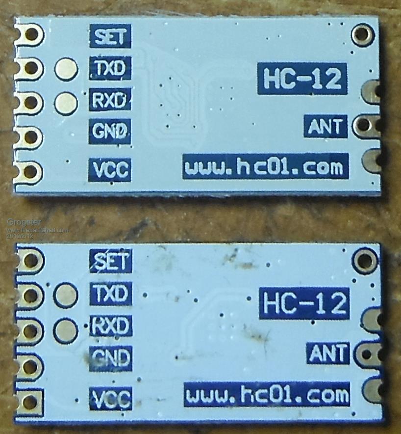

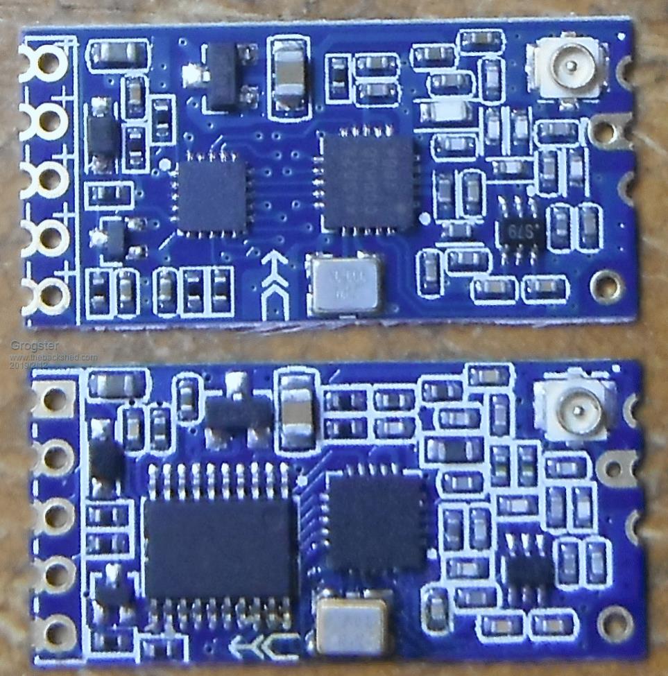

Hi all.
These are the latest module from hc01.
The new one is on the top, the old one is on the bottom.
Both the old and the new operate exactly the same, as you would expect - and are perfectly on frequency.
The most obvious change is that the SSOP has been changed for a QFN package.
This does, however, make it very easy to now spot the difference between the old and the new models, and genuine ones will have the QFN package on them - for now, until the cloners clone the latest model. I would expect that to take a little time though, so for right now....
RossW helped me get this batch, so my thanks to him.
Posted: 12:16am 13 Feb 2019
I see the new one has some more caps probably for decoupling. The QFN version might be a bit more reliable.

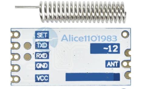

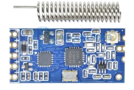

Posted: 01:04pm 15 Feb 2019
Looks like the clones are already out there.
front view
back view
Posted: 01:13pm 15 Feb 2019

Damn. I was not expecting them that quickly. The only way you can be sure, is to test each and every one for frequency accuracy, or buy direct from hc01 or the resellers.

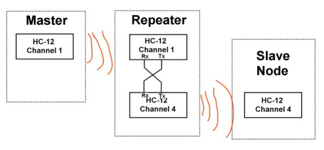

OK, I see what you mean between mesh and star. The example I gave above definitely uses a star. There is a "central" controller node (master) which initiates communication and no slave may start it. They all monitor the network waiting for their name to be called but stay silent unless that happens - remember this is not a technological feature of HC-12s but down to the protocol you devise and then encode in your own software. without a hint of mean-ness, HC-12s are quite dumb devices and just do what they are told - this is a major strength because all devices on a single channel just have a seamless access to a universal "surface" and can see what is going on.
A mesh as you define it is totally possible... it would be quite tricky because you need to mitigate collisions etc. The HC-12s have a pretty smart controller that handles all the radios (preamble etc) but I don't know what level of auto-retry and collision detect they have - I suspect little to none, which is not a negative in my view - I am far happier writing all that stuff myself knowing I wont be fighting with the hardware coz it is doing things behind my back trying to be helpful. As ever you want the system to be super stupid or super smart - if the latter then consider WiFi as that does have retry and mitigation in the event of packets walking all over each other. There are several devices that will get you going for that and I think if I was after a mesh I would be playing with ESPs devices... they are very good. I have used a few ESP8266 and I wrote a (fairly rough 'n' ready) module for working with them (as an addition to any prog) which you can browse here: http://www.fruitoftheshed.com/MMBasic.ESP8266-Module-with-HTTP-API.ashx . The 8266 is getting old now and newer devices like the ESP32 have a great report in the press. Of course being WiFi there is a degree of complexity you have to handle - unlike HC-12s. The latter also has a markedly better range than WiFi if you use it's highest power setting.
If you want to reach devices beyond range, you could do it transparently by having HC-12s back-to-back but on different channels... a small repeater would consist of two HC-12's and a PSU, nothing more. On the master end you could be, say, on channel 1 and the remote would be on say, channel 4. The two HC-12s would have their Rx/Tx lines crossed over and one on each channel. There would be a tiny delay introduced but that would work.
Would 2 miles of reach solve your problem? A star network is very much simpler to do. Similar blind spots would need a repeater but set the slave and secondary in the repeater to a different channel say 8 for good separation. Transmission windows (master -> slave, wait for reply etc...) would need to be opened out a tiny bit to allow for the relay to do its thing.
Although the repeater could be implemented with laughable simplicity, I might be tempted to put a micro-controller between them and relay through it because then you could make a standard unit with some switches on the outside to set the channels and the controller would read those and send the relevant AT codes to the HC-12s to alter their settings... but only if I wanted the repeater to be a standard unit I could drop in anywhere in any number... if I needed just a handful, it would be exactly as shown above. No point going to manufacture on just a tiny run that is easily achieved without it.
