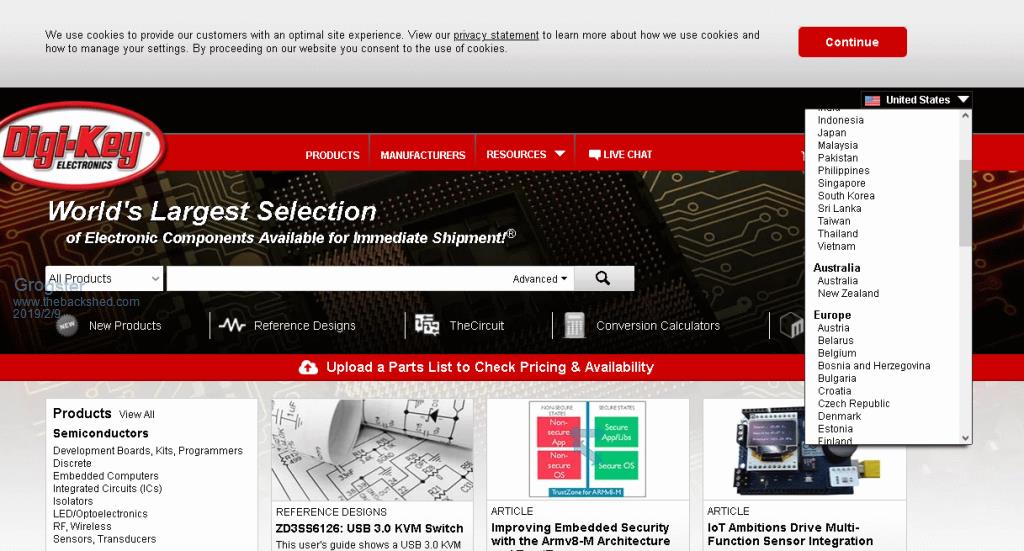

Posts: 10114
Posted: 07:26am 09 Feb 2019
Well, DigiKey list New Zealand as part of Australia - so whaddya think of that?!

Posted: 07:59am 09 Feb 2019
  Grogster said   Well, DigiKey list New Zealand as part of Australia - so whaddya think of that?!
Maybe they're listing by continent?
