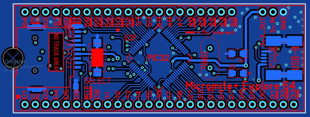

I have pretty much finished a new E64 design. This one is the same physical size and pinout as all the others, but includes the 1455 USB interface/programmer chip in SOIC, a Winbond W25Q series EEPROM chip for up to 16MB of on-board storage, and an 11A160 UNIO memory device. This is all I could squeeze into the board.
The board is now four-layer, but the per-board price breaks down to about $2.50 per blank four-layer board.

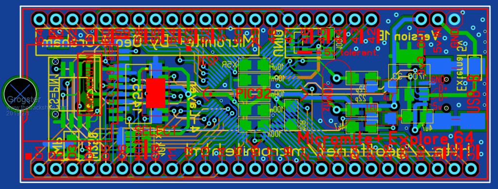

ALL LAYERS:

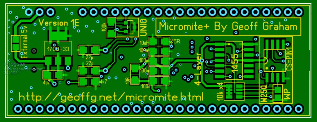

TOP LAYER:

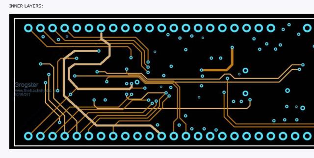

INNER LAYERS:

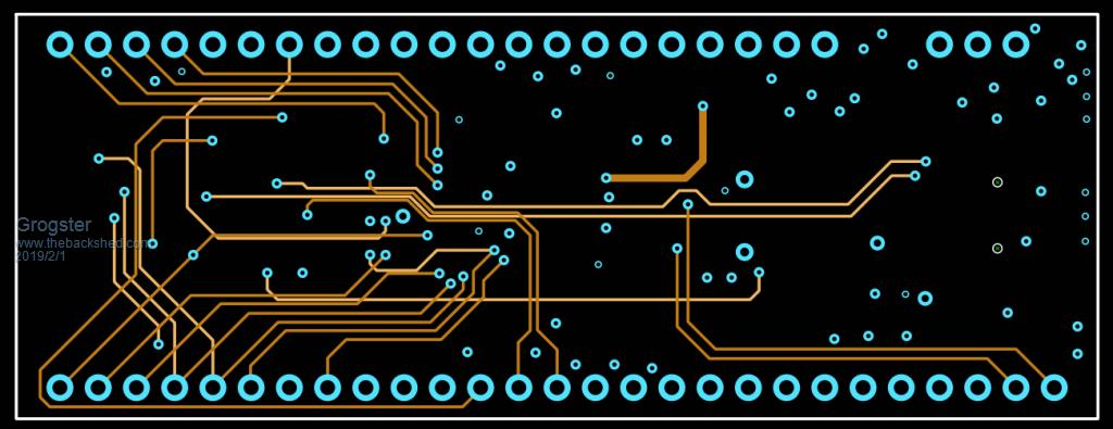

BOTTOM LAYER:

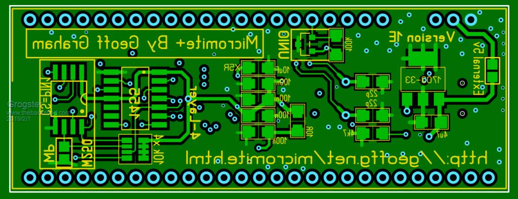

BOTTOM LAYER: (mirrored)
The W25Q SPI EEPROM chips are on SPI2 with the uSD card, but PIN-1 on the E64 is now reserved as the CS line for this chip.
The UNIO memory chip is on PIN-46.
Either/or/both of these can be installed if wanted - or not. Simply leave them off the board if you don't want to use them. The 1455 interface will be installed by default on any assembled boards.

I will check out the video. The default standard with a NEW four-layer board, would be to make the internal layers ground and supply - the E28 module is done like that.
The E100 is a four-layer board, and both internal layers are signal routing, with ground-plane on top and bottom. Never had any issues with the board at all with respect to noise, and hundreds have now been made.
Posted: 02:15pm 02 Feb 2019
if you wanted to eliminate the track around the outside edge on one of the middle layers, you could do this:
rob :-)

Posted: 12:34pm 03 Feb 2019
a couple more small suggestions:
1. the track on the top layer that runs between pins 60 and 61, and then along the very edge of the PCB to pin 47 can also be brought away from the edge by either pushing it down to the dark brown middle layer (vias on pins 63/62/61 of the mx470 may need moving a little left/up) and/or to the bottom layer.
2. and lastly the track from pin 2 of the SD socket to pin 12 can be broken with a via just before it passes between pins 6 and 7, then routed to pin 12 on a middle layer.
this removes all tracks that pass around the outside edges of the PCB on any layer. tracks on the very edge of PCBs always make me nervous!
rob :-)

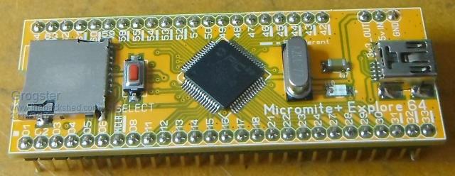

Posted: 04:57am 17 Mar 2019

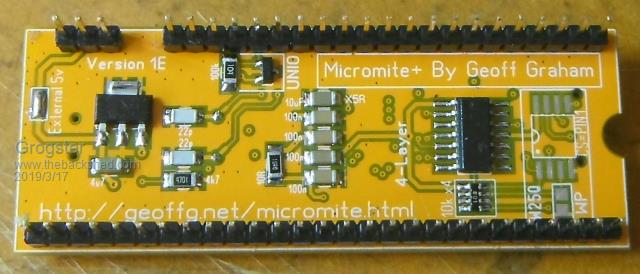

Here is the E64_1E prototype.
I cannot find the W25Q SPI memory chips I bought, so for this one, it has not been installed. I will add it later when I find the chips. It DOES have the UNIO memory(11AA160) in SOT-23 though, as I have found these chips very useful and they only use one I/O line unlike most other memories.
The boards were made with a 'Yellow' soldermask, but it comes back looking much more orange then yellow. Programmed the HEX in fine, initial tests of other things are now under way. One mistake I made was thinking(for some reason) that the 1455 IC's LED was on and only blinked when data was sent. It is the other way around, so this version of the board lacks a power LED. How much of an issue that is, depends on the person. The LED for the 1455 blinks brightly anytime something happens on the console, so it still KINDA doubles as a power LED.

Just a small cosmetic point that was immediately spotted, Grogster:
The word By on the bottom layer should be written by.
Since you are using title case, prepositions are written with a lower case letter.

@ LouisG - Thanks. I have corrected that for the next batch of boards. I'm surprised it was not noted before. ALL the E64 boards have had it like that....
@ Jim - Thank you. While I still like the 1D with optional daugherboard, I think this arrangement is neater, and then I don't have to sell the daugherboard separately. And I have squeezed in a few more features.
I might change the CS pin for the W25Q SPI chip to something else in the next boards, as I just routed it to the closest pin - pin1 - but that will conflict with anyone wanting to use an SSD1963 LCD panel. The UNIO memory is on pin46, which I don't think conflicts with any of the preset pin things. I will probably move the W25Q CS line to pin12, which does not currently seem to be assigned to anything.
