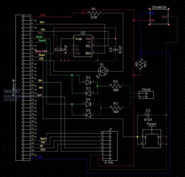

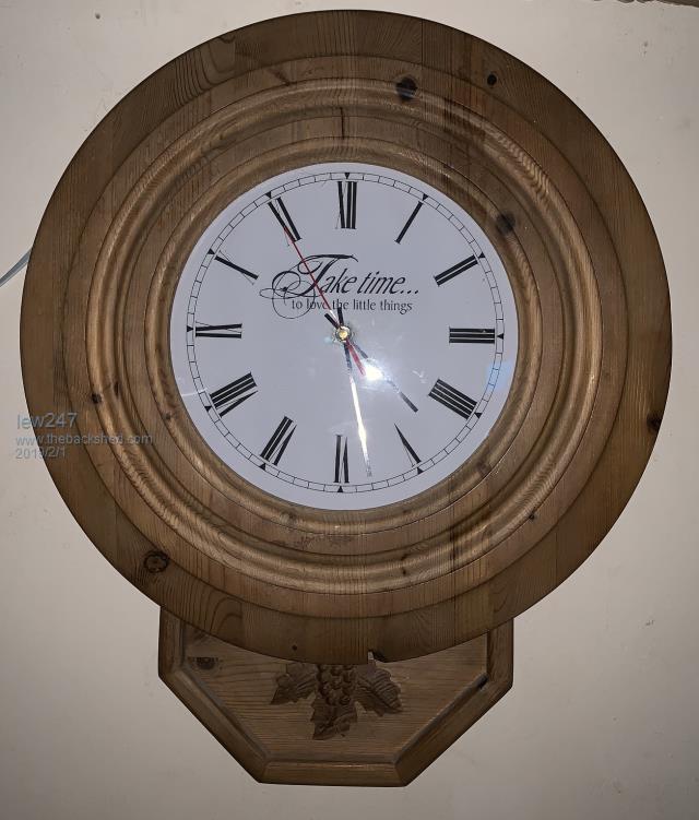

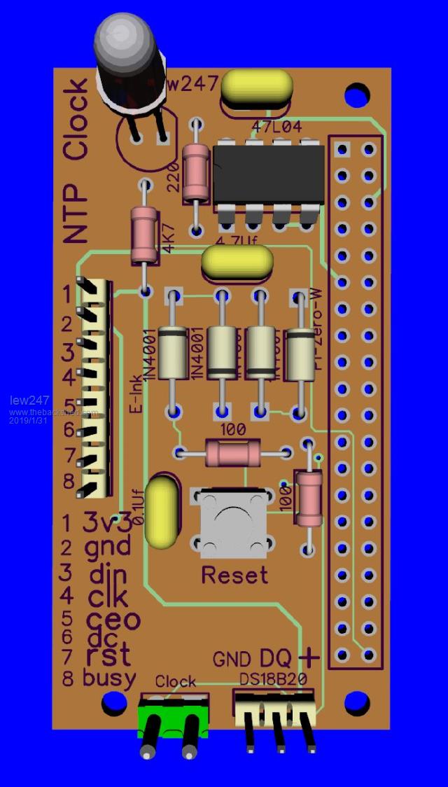

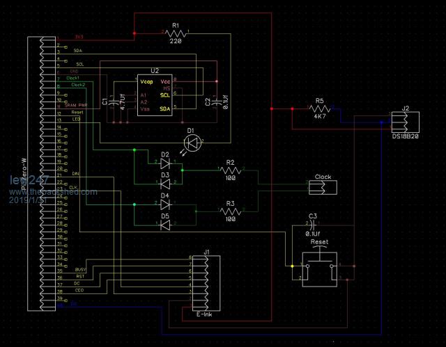

I've been working on an Analogue clock module for a few weeks and I'm finally happy with it
The clock works by using a normal cheap quartz clock module, opening it up and cutting the track that goes to the coil, it's important you cut both ends
Then solder a short wire to the 2 solder points that only are connected to the coil
The board connects an a Raspberry Pi Zero W which uses Raspbian, I've modified the code very slightly so it uses proper NTP time and gets the time updates from my local UK NTP servers and updates the time every 15 minutes so it's always correct to under a second with no RTC or anything needed.
It also has an Sram module that can be written to as many times as needed and if the power is lost it writes the last value it has stored into it's internal Eeprom whicb is then read back once power is restored
The time instead of using hours minutes and seconds are processes as seconds only, with 0 being midnight or 12:00:00 and counting up once every second
This value is stored in the Sram every second so the Picromite always knows the position of the hands as a value in seconds of the day
When the module is first powered up it has to have a small program sent to it to set the Sram value to "00000"
Then the clock code is loaded
Move the hands to exactly 12:00:00 and when your ready tell it to run
The clock gets the current time as seconds and knows how many steps to move the hands to get to the current time, and it moves pretty quickly to get there.
Once it's at the correct time it then pulses the hands once every second
Every time the hands move 1 second the counter for the Sram is increased by 1 until midday or midnight when it's reset to zero
If the power is lost, when it's powered up again the Sram is read, the Picromite knows the position of the hands, checks the current time and moves the hands to the correct time and then ticks once a second
If Daylight time goes forward the clock knows the hands need moving fast to catch up
If it goes back an hour the hands advance fast till midnight the Sram counter is reset to Zero and then the clock carries on to catch up with the correct time
There is a reset button on the board in case something major happens and the Picromite needs rebooting
Such as the clock being taken off a wall by a child and the hands moved while still powered up but the chance of this is very slim.
If this every happens simple press it then remove the power from the board, move the hands manually by the wheel on the back of the clock to 12:00:00 and then load the Sram program first then the Clock code and it will work as normal
I've not needed to do this at all and I've been testing it for a while
WW said about putting a button on the board to move the hands if needed if it every crashes but although the board I have now has that button I've removed it from the circuit as I can't see it being needed
There is a connection for one of the waterproof DS18B20's on the board this isn't needed I only included it because IF I can ever get an E-Ink display working with the Picromite then I'll use it to display the temp every 5 minutes and the day and date can be updated once a day
I don't think the E-Ink display works with the Picromite though as I haven't been able to get it working at all
My end goal is to use one of the Arm very low power modules once they are working good enough and it will then run on battery power for over a year
You can see it working here to catch up with the correct time

It's Still working, even after killing the power several times
YouTube Link

I just realised one thing
You do not have to move the hands should the clock hands get physically moved, OR if when you first set it up you find you have the hands positioned slightly wrong.
Just work out the number of seconds the hands are at when they stopped.
An exammple
7:10:01 is
7 hours = 60 seconds X 60 minutes * 7 hours = 25520
10 minutes = 60 seconds * 10 minutes = 600
+ 1 second = 25801 seconds
Just modify the Sram.bas file so line 10 says
[quote] r = writeDATA(10,"25920")[/quote}
That writes the current position of the hands to the Sram instead of "00000" which would mean they are at 12:00:00
Then run the Clock.bas program and the clock will catch up and carry on

***I made an error on the board which is why the E-Enk display wasn't working***
I've also modified the code
Now the hands can be at any position when power is applied or if the hands get moved manually by accident it doesn't matter
Run the file "Sram.bas"
It asks you for the position of the hands and then sets the Sram to the correct seconds of the day value
It doesn't matter if this is the first time you power the module up or not as long as you input the exact position of the hands
Then run "Clock.bas" and the hands will move fast till it gets to the correct time and then tick once a second keeping the time perfectly
2019-02-02_014006_PiClock.zip
Diptrace files also attached in case anyone is interested
