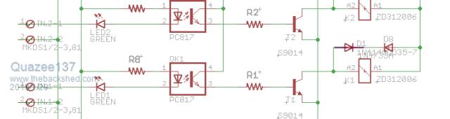

Last night I built 10 boards and had forgot that these where ok and ones and not
the ones with the bad transistor silk screen from last week.
As I was testing they all worked fine but then I saw the box of the other ones
and had to bread board the basic circuit wondering why they did work.
As it should be
The test I did.
Now why do the S9014's work with E-C switched around? Even did all the basic
transistor readings and they matched with E-C swapped go figure.

Transistors (NPN & PNP) can have their C & E connections reversed with no problems.
The gain will be less but they bottom to a lower voltage so the technique was often used to switch analog voltages.

Mentioned in the Errata in bigmik's 170 backpack pdf, with a link to this thread:
