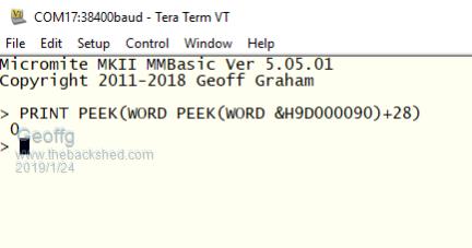

You could use the following to test if the touch calibrated Zero means no, non zero yes.
peek(word peek(word &H9D000090) + 28)
However, as Grogster said, you must run GUI CALIBRATE from the command prompt.

i try :(in my code)
PRINT PEEK(WORD PEEK(WORD &H9D000090)+28)
i got : Error Address
Posts: 3372
Posted: 09:45am 24 Jan 2019
It worked for me:
